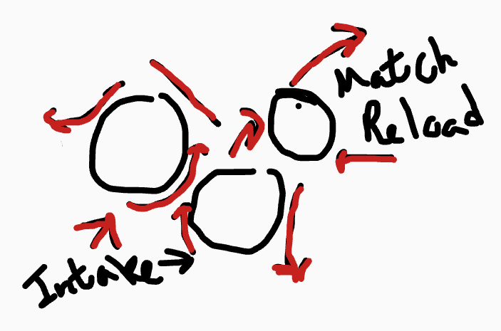

So I’ve been doing research on intake options now that my team has a drivable chassy, and I had an idea of using some type of spinner. I was just wondering if anyone had an idea about what I could use besides Omni-wheels, and how good of quality it would be. I figured I could use the spinners for not just intake but also match reload if I added a third one on the top that connects to the intake, but I don’t really know how to do that :sweat_smile: I just want some advice from people with experience :smiley:

Let me guide you through this image
As you see, there are 3 spinners (I don’t draw good on chrome… only on paper lol)
I was thinking, the 2 bottom ones labeled “Intake” would be used to Store triballs. However, if spun long enough, it comes into contact with the third spinner, and then the third spinner activates after the other 2 have deactivated, and the third one sends the triball into the field
Does this clarify at least some?
I see what you’re trying to do and I think it’s a good idea, but I personally think that there could be some redundancies that you could try to improve upon
I think that the top spinner and the spinner at the bottom are necessary for your intake, and it will probably also be very helpful if they work in tandem to intake a triball. However, I find that the second spinner that is part of your intake (the one I’ve circled) seems to be unnecessary to me since its main functionality is simply just to introduce match reloads to the robot (unless there is some other functionality that I’m not seeing). Instead of introducing match load triballs through the second spinner, you could probably place it directly on the bottommost or third spinner, and it’ll be able to be introduced into the field if you reverse the intake or if you use the third spinner that you’ve suggested.
Don’t forget that you can only possess one Triball at a time. As a result, you can’t store multiple Triballs on the robot at once.
Do let me know what you think though! If you have the time, you could try and experiment with this design. I think I see a potential use of utilizing your design with 3 wheels/spinners, but it’s not for match loading but something else instead.
