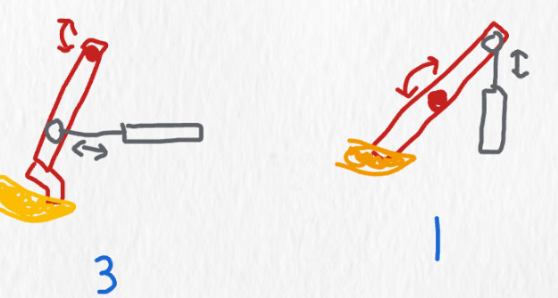

Or… you could use a lever… and have 2 actuators (for extra extra strength - that’s what we do). The most popular type of “lever” this year seems to be class one or three levers, as illustrated below:
Class one levers do present a mechanical advantage, but do take up more space. But even with both these levers most teams still use 2 actuators.
Alright that makes sense, in hind sight using a plug on the piston too would leave trapped air or a permanent lack there of, as well as a little bit more weight. I definitely have seen more class 3 levers, Class 1 levers are too bulky so most teams don’t use them. But overall using a lever will be better. I actually saw a team that used standoff and stuff to make a class 2 lever which was interesting, it poked out pretty far so I wouldn’t use it but interesting concept.
I tried a class 1 lever for my kiwi drive robot. I wouldn’t recommend it, the arc it follows made it unnecessarily hard to tune. the one I had would either press down on the top lip (raising the mogo but not secure) or pull it straight in by catching the lip depending on what a put on the arm. I ended up solving it by using both of these together, but it was overcomplicated and still not very secure.

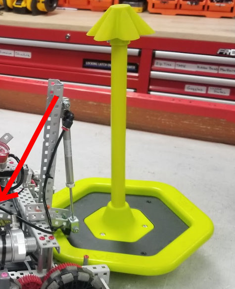

Here’s an early season prototypes we built and tested.
This prototype used an older 150ml pneumatic tank and
a single action cyclinder to push the 1st class lever down onto the mogo.
We used a single rubber band (not shown here) to retract the clamp.

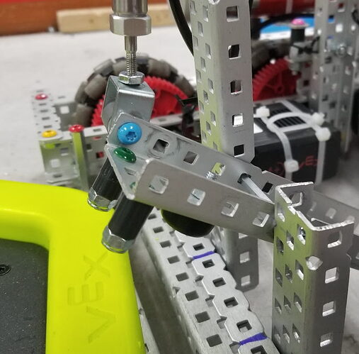

Later after testing, we ended up moving the cyclinder to the rear portion (red line and arrow) of the class 1 lever to avoid damage to the cyclinder during aggressive game practice.
Once at the rear portion of the lever, we tuned it for greater clamping force by moving the cyclinder mounting point one hole at time further away from the fulcrum point. At some point we found we could clamp a FULL mogo tightly and securely for around 6 actuations.
