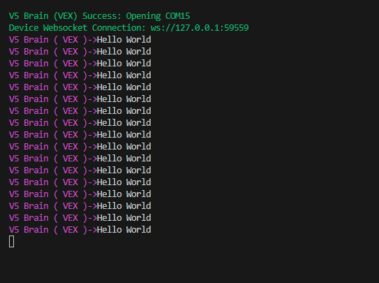

  3. In your c/c++ user program I would start out with something simple like printing “hello world” on loop:
     while(1) {
       printf("Hello World\r\n");
       vex::this_thread::sleep_for(1000);
    Once you start the program on the brain, you should see something like this in the integrated terminal:
    The purple text tells you which connected VEX device is sending data to the Websocket Server.

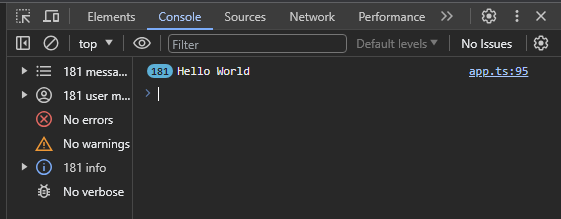

  4. Check the data received event handler for you client websocket to verify your external application is receiving data from the Websocket server.
    In my case, since I’m console logging the data , I checked the console log in the browser.

We tested this several days ago. We created an HTML file attached a JS file containing the scripts above. We opened up the HTML file in Microsoft Edge and we got similar results, though the the purple “V5 Brain ( VEX )” only appeared once every time we run the program. Thanks for helping!
