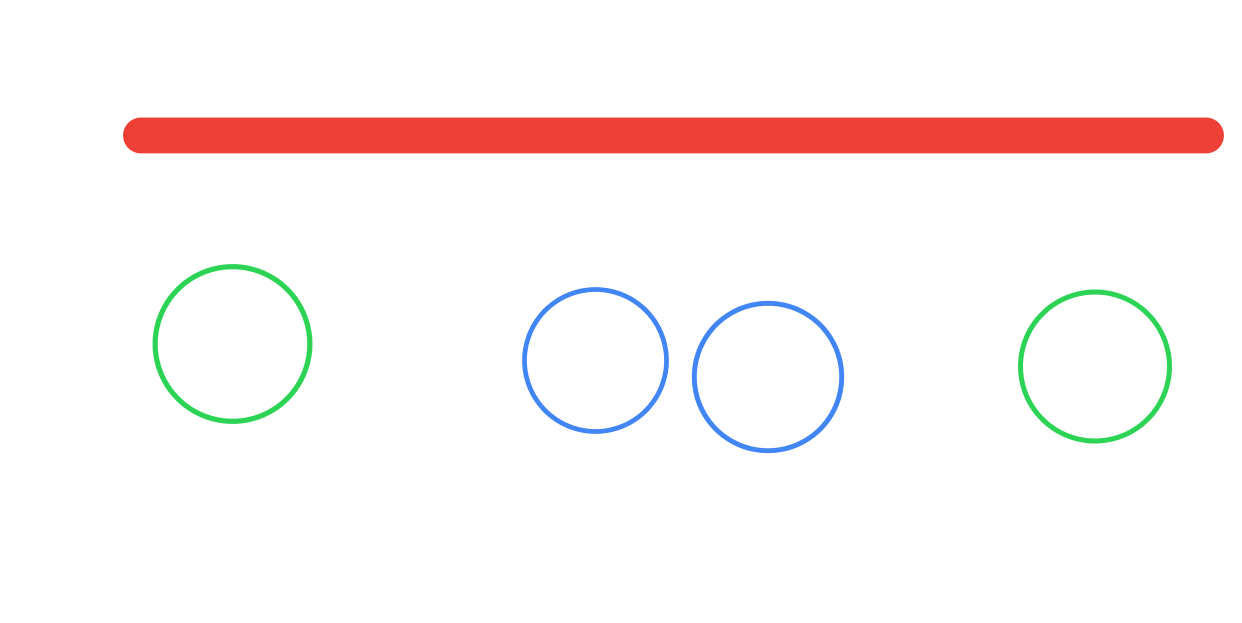

@Doctortictac The red is the back of the chassis, should I have the antitips where the blue or green circles are? It’s not to scale, the anti tips will be farther away from the chassis. @ranOOm ATM the ā€œthingsā€ are 60t gears covered in mesh, but that isn’t finalized and might change in the future
I would use omnis with green inserts instead of a gear.
You would want them at the green because that is easier to make and it supports it well if they’re out enough. 1961Z has greens and they work extremely well in matches, if you watch them.

Where you place your anti-tips, whether the green circle or the blue circle, is entirely up to you. To help you with your decision, farther apart anti-tips help with stability of your robot when you’re on the anti-tips (less chances of tipping side to side), but an anti-tip closer to the center of your robot will make your robot less wide at the back, and may make it easier to drive around (if your driver will notice the difference).
You should try to make your anti tips something that can slip sideways - omnis are going to be a better option, use a screw-joint on the wheels and you should be ok.
Another common end piece if you don’t have room for omni’s is a spool from the winch and pulley kit with surgical tubing stretching around the circumference, and spacers on the surgical tubing loop. Basically creating ā€œcustomā€ omnis that are much more space efficient

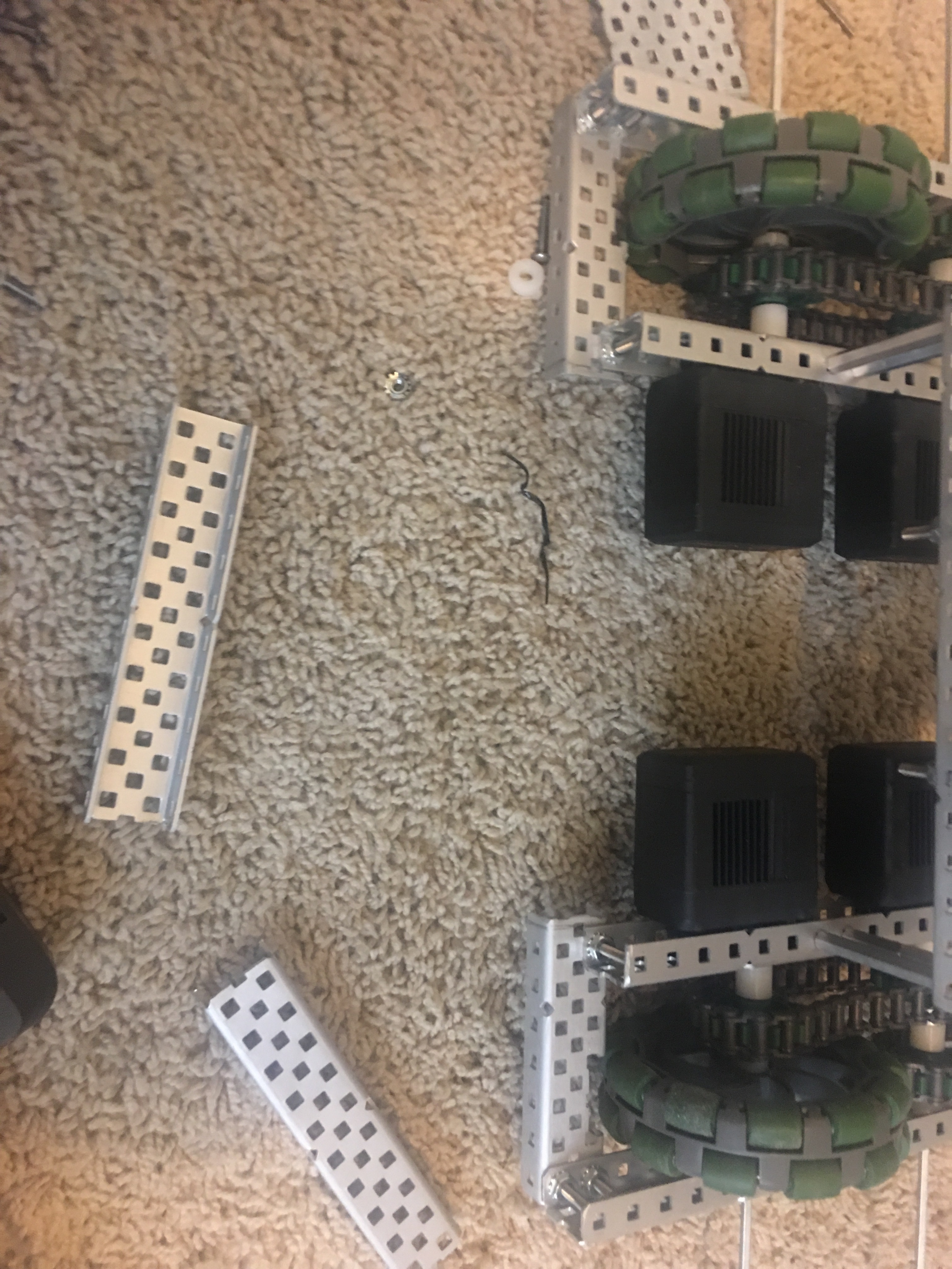

I was planning on using wheels before but the problem is the their too wide and would be up against a motor powering my back wheels. I don’t have much room until I’m out of size constraints so I used a gear. I don’t have the equipment required to cut wheels in half nor any places nearby that can cut them for me. I can order pulleys and use those but from the looks of it pulleys aren’t a good idea
you don’t have access to a hacksaw? you can cut 2.75" omnis in half with a hacksaw pretty easily.
I did not know that. I’ll have to try that out and hope I don’t ruin my wheels XD
don’t do in unless you have to. if you post a picture of the back of your bot we can help you come up with another option.
K I’ll be back home in 20-30 min so I’ll do it then
ok so you have a lot of room back there. you could easily make top down folding antitips, or linear extending antitips. I wouldn’t cut omni wheels just to have flip out antitips tbh.
