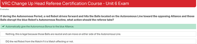

This is an interesting topic to bring up @9MotorGang, and timely since I just went through the reffing videos and head referee training today. A question on this aspect of the rules threw me for a bit. Here is the question from the ref training course:
After some more reading and searching the Q&A, I found this post which I think most directly speaks to this issue:
https://www.robotevents.com/VRC/2020-2021/QA/595
To me, the key determining factor that a ref needs to use to make this call is summed up in this sentence in the Q&A post:
To your scenarios, I would say that 1, 2 and 5 are the only ones with the potential for it to be an automatic awarding of the autonomous win to blue, but I don’t think there is enough information in your scenario description to know for sure.
After going through the videos and the training, I think this is the rule that will be the most open to interpretation and a judgement call for refs during matches, especially if you are talking about robots interfering with each other while trying to score on any of the center goals during autonomous. I think it will be an easier call to make if a red robot pushes a center ball into the blue zone and it ends up interfering with an autonomous routine that is designed to score in the home row of blue. It will likely end up being a bit of a toss up if a team gets penalized for something with those center “shared” balls.
If you are comfortable living on the edge, then go for them. If you want to play it safe, stay away from them.
As to the scenario @2775Josh mentioned, I think the Q&A I referenced would show that, taking the description at face value, it would not lead to an automatic awarding of the autonomous win to blue. However, there may have been other aspects at play that I am unaware of.
