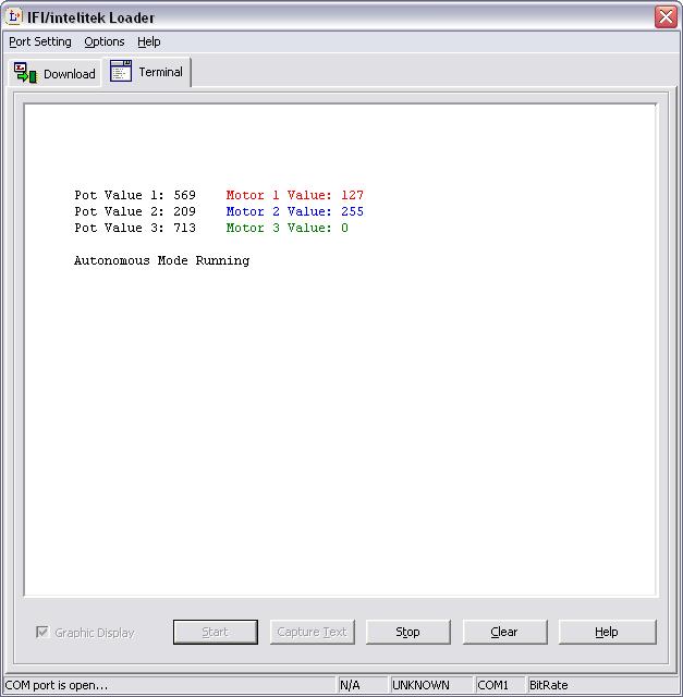

I have a much better answer, because you are using easyC Pro. easyC Pro allows you to address the terminal window. So, you can create static displays with multiple variables showing at once. The only catch is you can’t mix PrintToScreen and Graphic Display it’s one or the other.
For more information and a sample program drag in the Graphic Display block and click Help.
SampleGD.zip (2.24 KB)
I have been trying to use the graphic display for a couple of years now and one of the things I have not been able to solve is the refresh problem. So, when I stumbled across this thread, I thought it would solve all of my problems. Little did I know that it would only compound them!
I tried your sampleGD program exactly as is and I received a completely blank display screen. (Yes, I did have the graphic display checkbox marked). When I changed the field width from “%4d” to “%d”, it displayed fine (except for the refresh problem). My new question is, why does specifying a field width cause my display to go completely blank? This has happened to me in other programs, not just this one.
