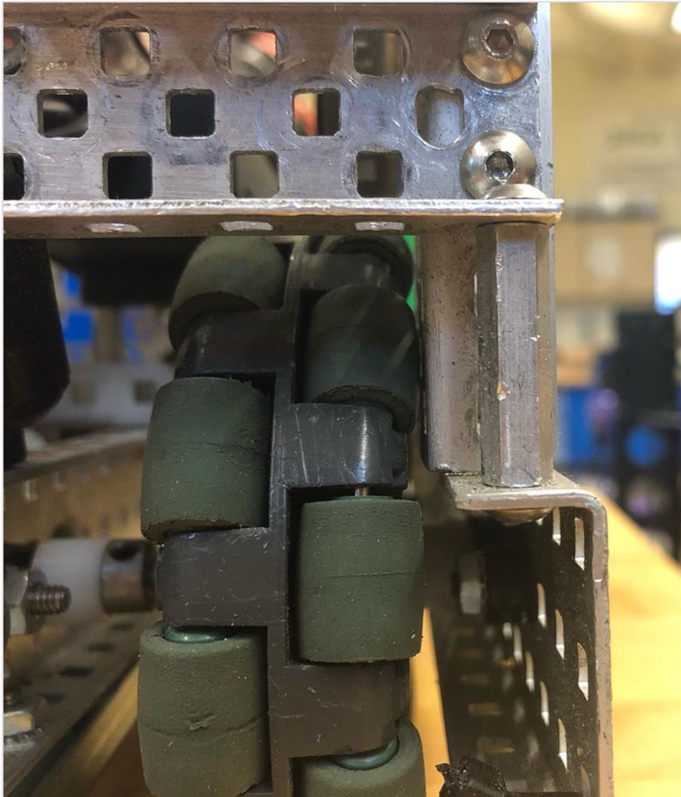

Screenshot_20200602-131719_Chrome
Here was our clearance which never negatively impacted our robot during TT.
so in theory that brace is safe, but in practice the wheel probably will be able to rub against it if it has enough wiggle. I would move the wheel forward by one hole just to be safe, it shouldn’t effect your robot too much.

well that gap looks really tight, and there is no garuntee that real omni wheels will fit there. the ones in cad could be a tiny bit smaller, and manufacturing tolerances could mess stuff up.
personally that tolerance looks too close for comfort.
you could easily test it though, just build a little thing with those dimensions, and see if an omni wheel fits.
I will definitely test it. I know that the little rubber pieces stick out a bit, so the wheel could definitely hit the brace. Plus CAD is using a perfect omni wheel and in practice wheels aren’t perfect. If I decide to use a couple metal washers will that be fine or will it screw up my spacing when I attach c channels to that brace?
I would build it but first test by rotating the wheel to its tightest spot in CAD and measure the clearance there.
Can’t disagree with you there, but at that point @Athan is better of just raising the brace slightly with a few washers, no big deal. A lot better than shifting the whole wheel forward
Okay cool because I’ll probably be adding a couple metal washers just to be safe. I don’t want the wheel to ever be scuffing on the brace
