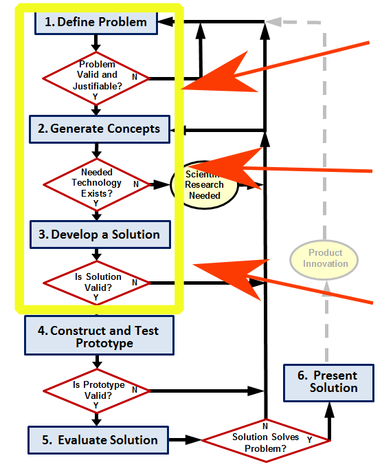

It isn’t always the best idea to “try it and SEE” without doing any research beforehand.
In the design process, building doesn’t come before… literally almost everything else:
Either way, please be respectful.
