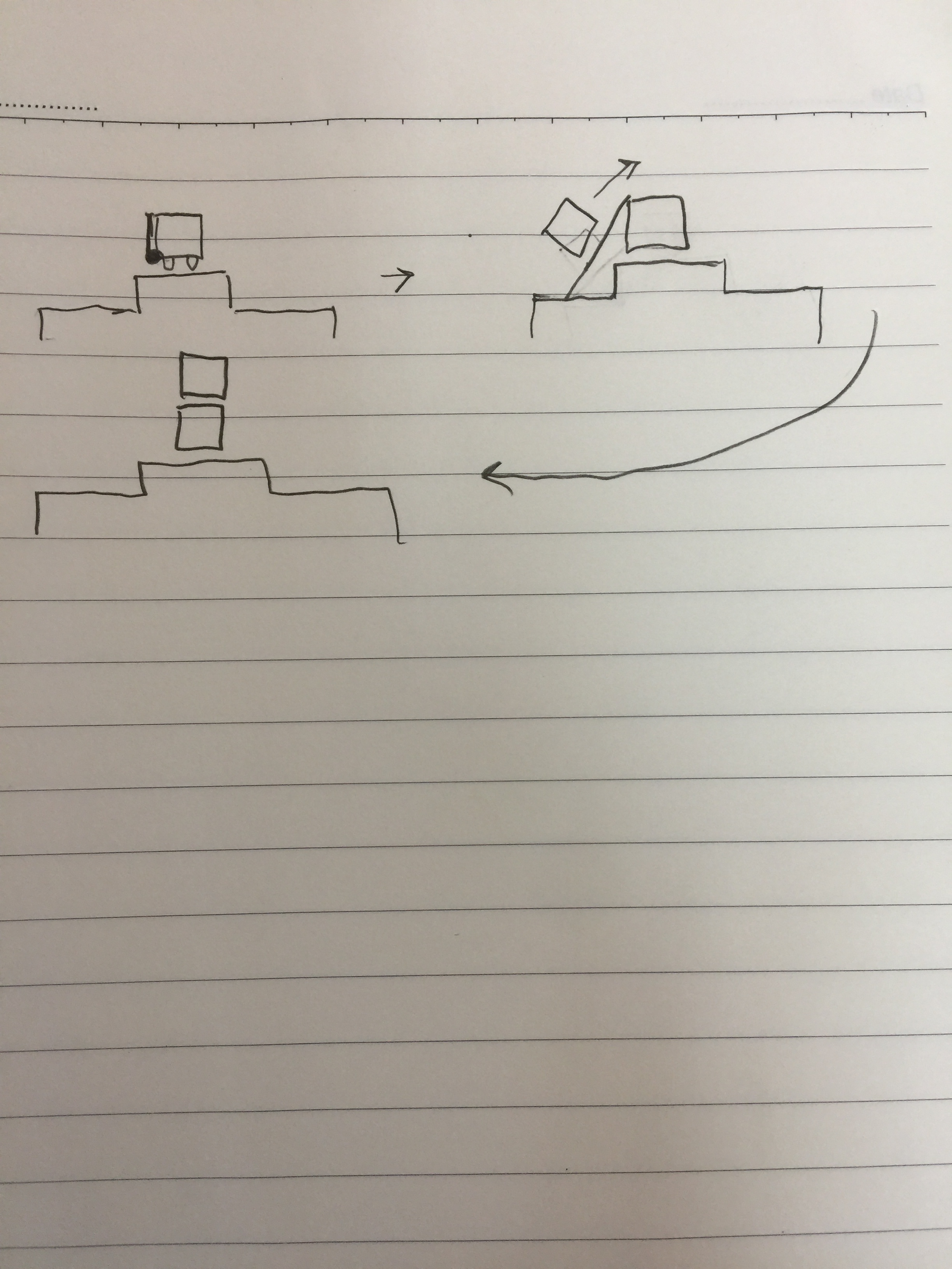

Hi all. I am wondering if it would be a good idea to implement a system where a ramp would come off your robot, and your partner could drive on top of you, so you get 12 points from the center park? Is there a problem with this?
Although it might work, for the park to count robots need to be contacting the platform and you couldn’t just drop something down so the robot is contacting the platform as there is the 18” height limit.
Well, there’s some ambiguity with that lol (I was talking with some people about it). The rule doesn’t specify whether being in contact with another robot that meets the criteria for center parked would make the other robot center parked

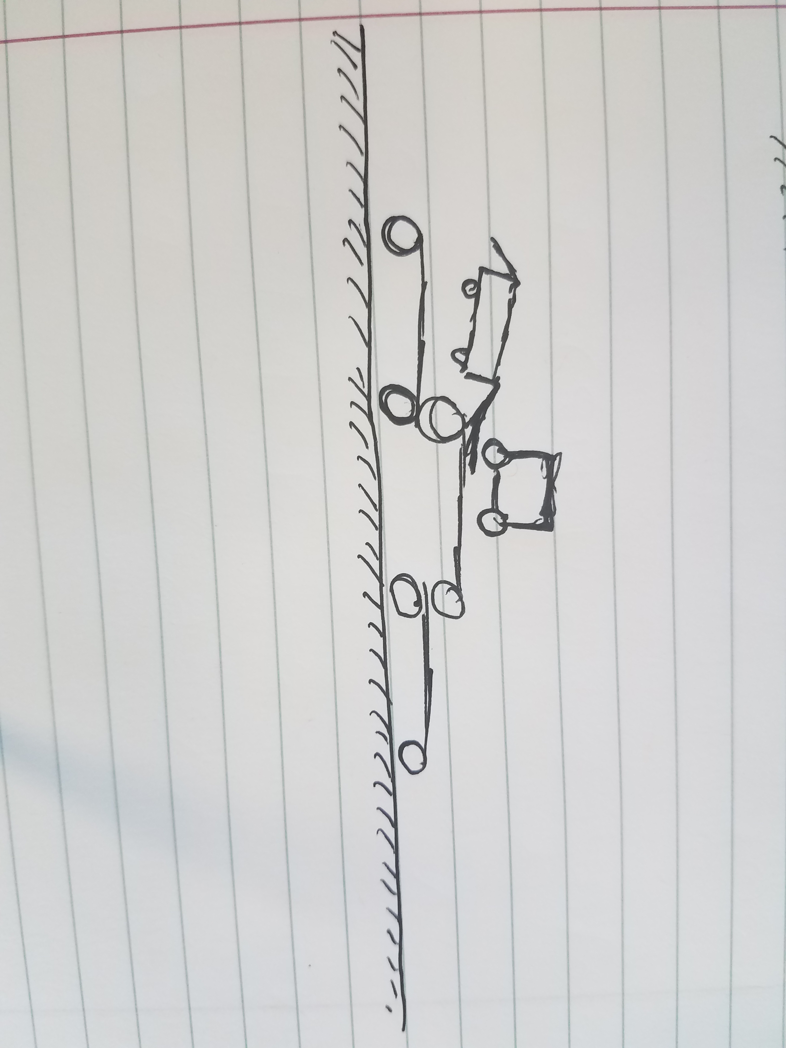

A very short and light, but rigid, robot designed to easily reach the alliance platform and then fold out a short ramp on either side to help their partner up to the center platform, and designed such that their partner would remain parked on the second ramp with enough weight to lift the robot off of the alliance platform. Would not be very valuable late game, but early on guaranteeing you and your partner could get 12 points would be pretty nice.

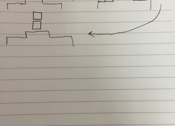

Hi. So just a clarification. We would dedicate 1 motor, so that we could drop it down, then when the alliance is on top, we would pull up. Attached is a digram of the idea. The only thing to think about, is that the partner would not be contacting the center platform. They would be on top of you. Would this still count?
according to the definition of “center parked” they need to still touch the center platform. So it would only count if they were also touching the center platform.
Maybe you could put an open section at the front that their wheels would sort of naturally fall into - if their wheel was touching the center platform, and the rest was suspended above anything else, I would think that should count as parked. Neat idea! Worth an official Q&A to determine if they need to be touching the actual platform or if they count because they are only touching you and you are only touching the platform.

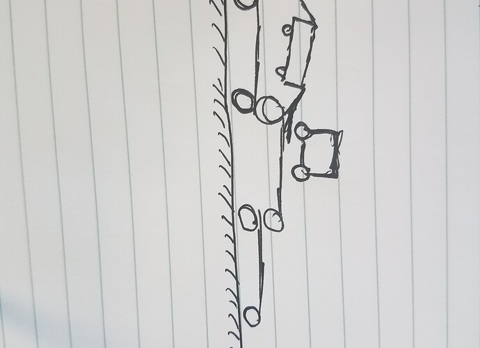

You could also have a small hook that attaches to your team mates robot, so that even if their robot is hanging in the air some it would still be sitting on the platform.
You might be able to dedicate one motor to a winch of sort and grab hold of their robot and pull it up. just a idea.
