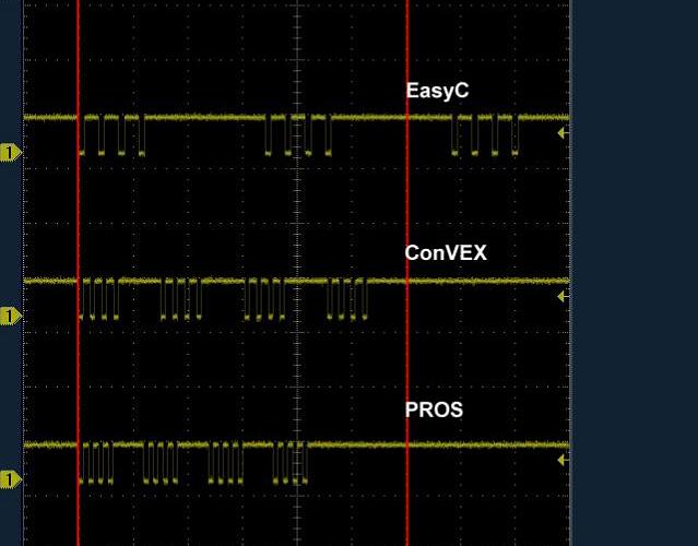

I don’t have a cortex here at work but I did take a quick look at data I collected a few weeks ago.
As you know, the SPI communication consists of four groups of four words with a small delay between each group. Looks like perhaps you have 40uS-50uS less delay than everyone else (meaning ConVEX, ROBOTC, EasyC and the IFI default code). I do need to verify on the scope as I don’t have all the information here. How are you doing the delays between words and groups of four words?

I had a look at the SPI timing for all the development options I have as well as the IFI default code. I’m not going to explain too much of this, it’s really for the Purdue guys. The communications consists of 4 groups each of 4 16 bit words with a small delay between each word and also each group.
This first composite scope picture shows the timing for the four groups, it’s a capture of the slave select signal, the IFI default code is shown at the top as a reference and then each flavor of firmware.
[ATTACH]7778[/ATTACH]
The second image is the same thing, just zoomed in a little. I show the delta between the end of the first group and the start of the second, I think PROS may be pushing the envelope a little.
[ATTACH]7777[/ATTACH]
I will leave it to the PROS team to decide what to make of this information.
We did attach a scope to the SPI lines on our STM32F103 test board and checked the timings. The results were similar to yours. However, leaving the scope running for hours triggering on bad packets was not an efficient use of tester time, due to the low frequency of occurrence on the Cortex units we have for testing. JTAG debugging revealed good information about the Cortex memory state to track the issue down to single bit/byte errors, but any kind of invasive debugging involving breakpoints, single stepping, or watches obviously disrupted the Cortex enough to hide the issue.
We recently had an issue with a faulty custom sensor driver with its interrupts mistakenly programmed at maximum priority, driving the SPI timings out of spec and causing a run away robot. While we were debugging this issue, we developed an accelerated test program involving two Cortex units running with a computer controlled competition switch rapidly swapping between teleop and autonomous, to expose the issue much more frequently than our previous test model. After the sensor driver was fixed, this model caused other SPI errors frequently enough to expose a race condition on an index counter that was likely causing the problem.
The latest revision of PROS, 2b08, incorporates extra SPI timing margin and the fix mentioned above. We believe that if the SPI timing was indeed too short, then the issue should come up more often than once every few minutes or hours. On the accelerated test model, we had no occurrences of the issue on the latest version; this does not mean that it is totally fixed, but it should be an improvement. edjubuh, could you try upgrading PROS (and updating the project you are testing) and see if the issue disappears?

For anyone that’s interested, here is the revised SPI timing PROS is using in 2b08 as compared to 2b06. At this point I’m in agreement with the PROS team and suspect this has nothing to do with the original bug. We (PROS and ConVEX) are guessing about how the master processor reacts to the SPI timing, we have no information that indicates that it’s even necessary to leave these short gaps between groups. It does not follow common practice for most embedded SPI, but I’m sure there was a good reason originally. I tend to use ROBOTC as the reference implementation for this type of thing, I have great respect for the ROBOTC developers and trust that they know what they are doing. In this case, however, I also decided to tighten up the timing a little and also allow other tasks to run between the SPI groups. I will say that EasyC (in version 4.1.0.5 that I tested) is extremely wasteful of cpu resource, they are using almost 1.5mS to transmit the data in this version with a period of around 20mS. I looked at some old data I had and this did not used to be the case, I have an idea of what happened but that’s for them to sort out if they want to. Just be aware almost 8% of cpu time in EasyC seems to be dedicated to this process.
[ATTACH]7784[/ATTACH]
