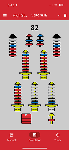

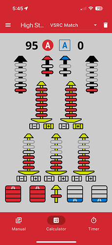

I believe during match is 95 and Skills is 85. Might be slightly off though. Especially with the weird Skills rules.
this would be the max for skills without having to descore the blue topped ring goals and a tier 3 climb plus high stake.
this should be the max for a match
