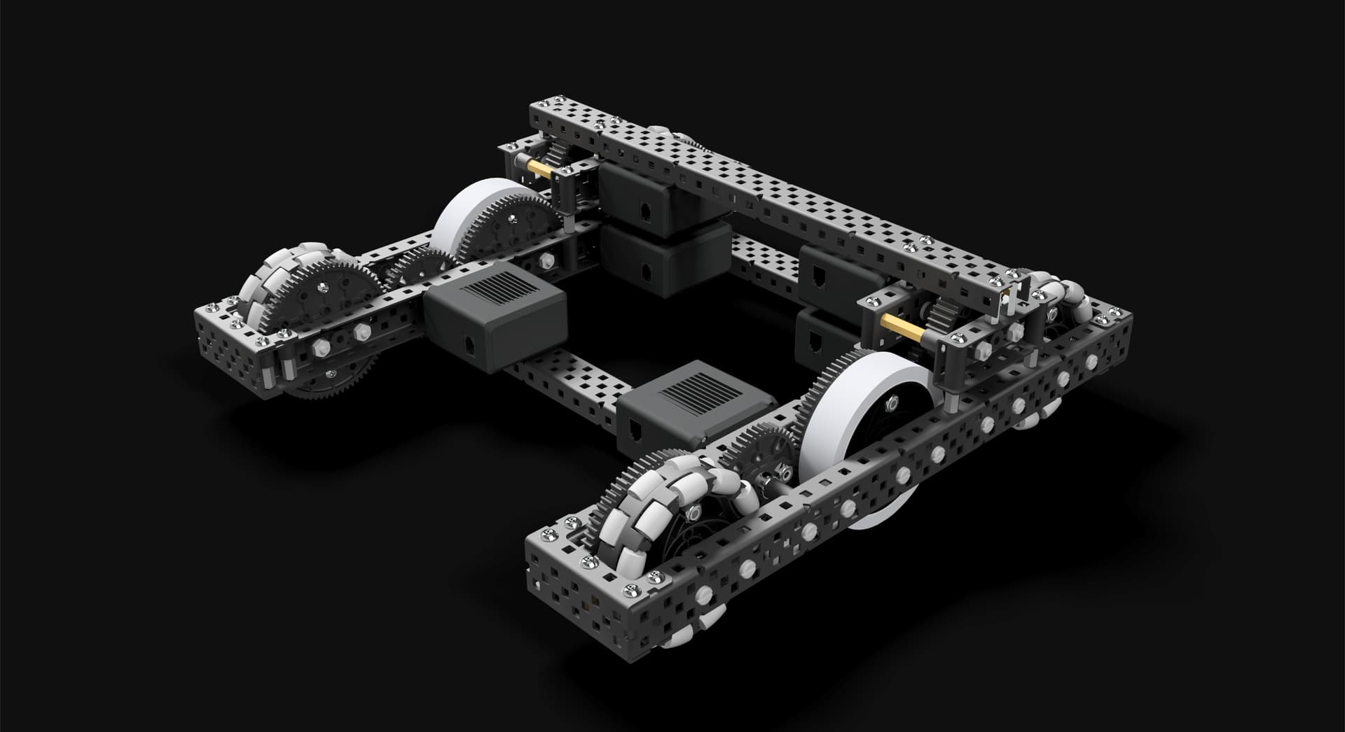

The reason I thought not many teams used high strength gears is because most drivetrains I have seen use low strength gears for 3 hole gap.
somewhat similar question- is there an advantage of using 3 or 4 wheels per side (instead of just 2), if you’re not using center traction? I see a lot of teams doing this, but I’m not sure why.
3 HOLE GAP!!! there’s no way! the smallest anyone can get is 5 hole with ls gears.
3 hole gap is very possible because you can fit an Omni wheel and a low strength gear in 3 holes. Here is an example of what it might look like:
Many teams use 3 hole gap to have thinner wheelbases allowing for more space in the rest of the robot.
What he means is the gap between the C-Channels of the drive is 3 holes, so when you include the c channels it is a 5 hole wide drive pod.
oh ok, I though he was talking about 3 hole including the outside
but nice cad, super clean, did you make this yourself?
Oh mb yea having 3 holes including the outside is impossible. Not my CAD, I wish, just some image I found online.
