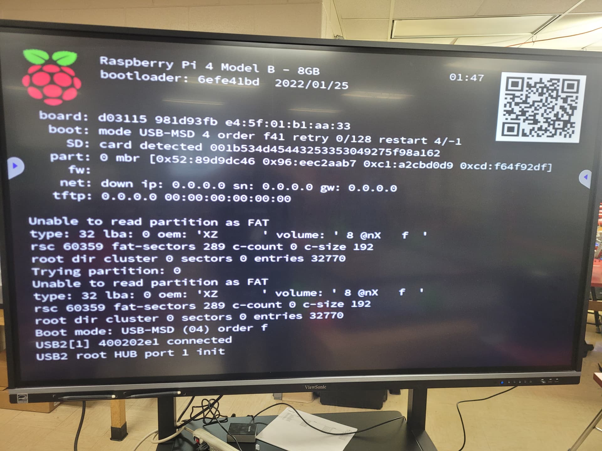

Raspberry PI for display not working. Attached is error message.
Any help appreciated. I am new to the World of Raspberry PIs. Downloaded latest version of TM this afternoon from website. Below is image on display when PI started.

The image you downloaded is compressed (like a zip file) in the xz format. It looks like you wrote the .xz file directly to the SD card. You either need to extract it first and write the image that’s inside, or better would be to download the Raspberry Pi Imager tool from the Raspberry Pi website and use that, since it can extract the .xz file on the fly.

No, none of that is needed. Writing a disk image to an SD card with Pi Imager and similar tools completely overwrites any partitions and formatting on the card.

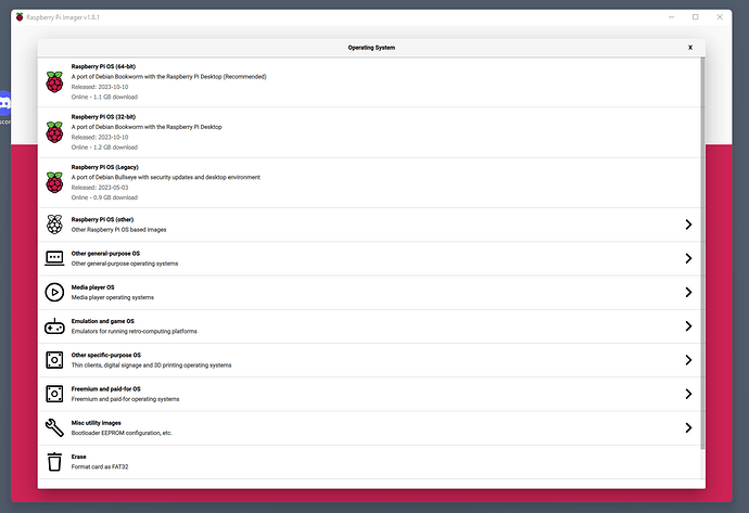

If you scroll all the way to the bottom of that list, there’s an option called “Use custom”. Select that and then pick the .xz file you downloaded from the TM website.
Last one, Use Custom
