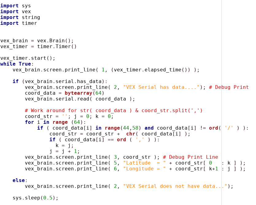

On Vex Brain. we use VEX Serial functions to read the Serial Data.
Following is a working code snippet that we use on Robot Mesh…

python uses a generic float type, there’s no limit on the number of decimal points.
Looking at your code snippet, the coordinates never even get converted out of strings, so the issue is just that however you’re transmitting the data is truncating it.

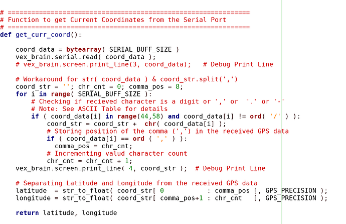

I actually had to add this code because float conversion was not working in Robot Mesh.
The frac_value in code below is exact before division.
The primted value after division by 10**frac_len, and addition of integer value.
some how is reduced precision.
Same goes for split and rstrip…

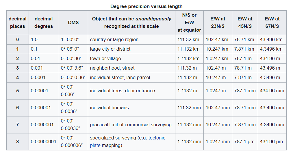

GPS_PRECISION = 8;
You are mixing precision vs accuracy. While you can do 6 decimal digits of precision, the existing GPS setup does not give you the accuracy you need. Unless you have a solid lock on 5 or more references, you are going to be in that much larger bubble of “you are here”
