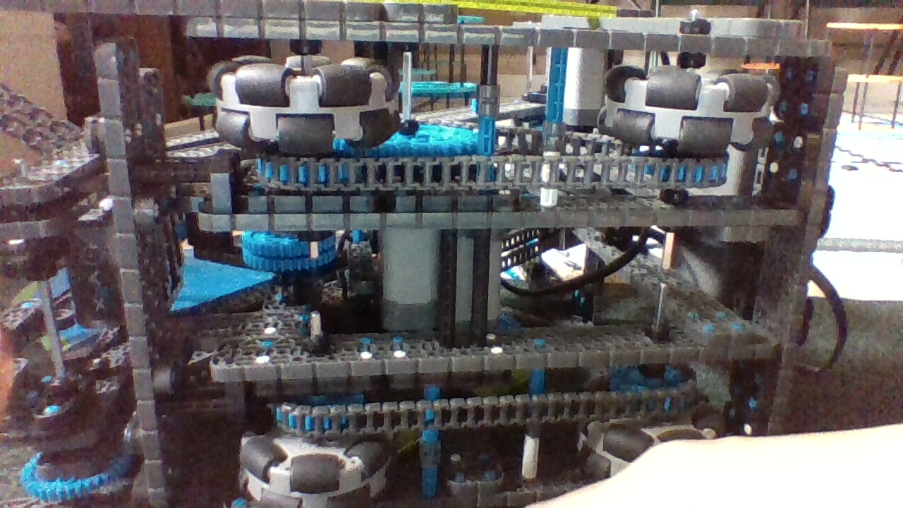

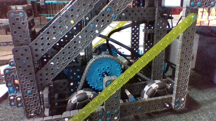

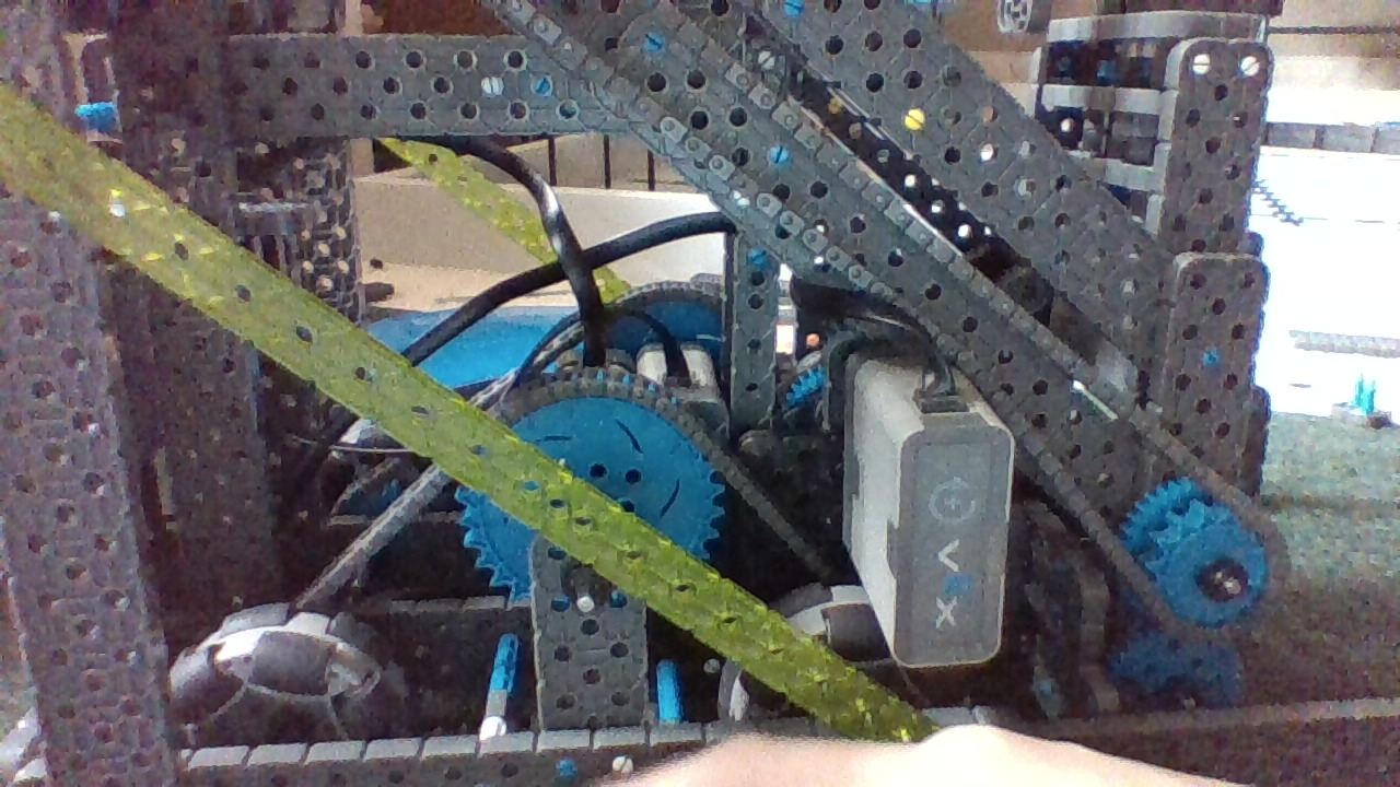

I’ve been having a bit of trouble with our back-up meta robot’s drivetrain (we’re building razorbill as our backup) One side moves faster than another by a considerable amount. Does anybody have any ideas why? The first picture is the side that moves faster, the second has the slower side on top, and the third is the slow side… Thank you

We have had this problem on many robots, but particularly lighter ones. This can be for a couple of reasons:
  1. There is more friction on one side of the drivetrain than on the other. This can be solved by inserting some of part 228-2500-112 at the friction points.
  1. One motor is more powerful than the other. This can be solved by switching around motors until you find two evenly matched ones.
    Unfortunately, VEX IQ changed the motor in 2018, and according to my extensive observations, the new motors are less powerful than the old ones, so this makes this more of a challenge. But for fairly new teams, this isn’t an issue.
  2. Also, if your chain is too tight, it can cause this problem. If this is the case, make both chains have equal not too tight amounts of tension, but not so little that they slip on the sprockets.

Wow, thanks for the help. I guess the chain was too tight. Adding one more unit to each side really helped. Thank you! As for our robot, I’m sorry but I don’t think that I can share the design right now, although I will tell you that it isn’t better than razorbill yet. We’re still coding it.
