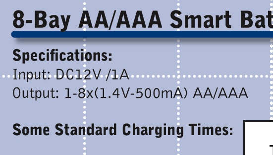

I already told them that I thought it was a bad idea, but on the behalf of the students, and in case anyone else wanted to try it, I thought it best to get an official response from VEX.
Spec for the AAA charger is 12V 1A DC supply.
[ATTACH]5668[/ATTACH]
I don’t know what the spec for the old 2 bay charger was, they can check if it’s 12V DC but they would also have to check the polarity of the plug (is it positive on center or outer contact).
This looks like a suitable replacement, it’s center positive so compare to an existing charger (I don’t have one here at work) to see if it is the same. Check the plug diameter as well.
This is the spec for the Pololu device
This 12W, “wall wart”-style switching power adapter supplies up to 1 A at a regulated 12 VDC. The AC adapter works with input voltages of 100 – 240 VAC and has a 1.5 m (5 ft) DC power cord that is terminated by a center-positive, 5.5 × 2.1 mm barrel connector.
