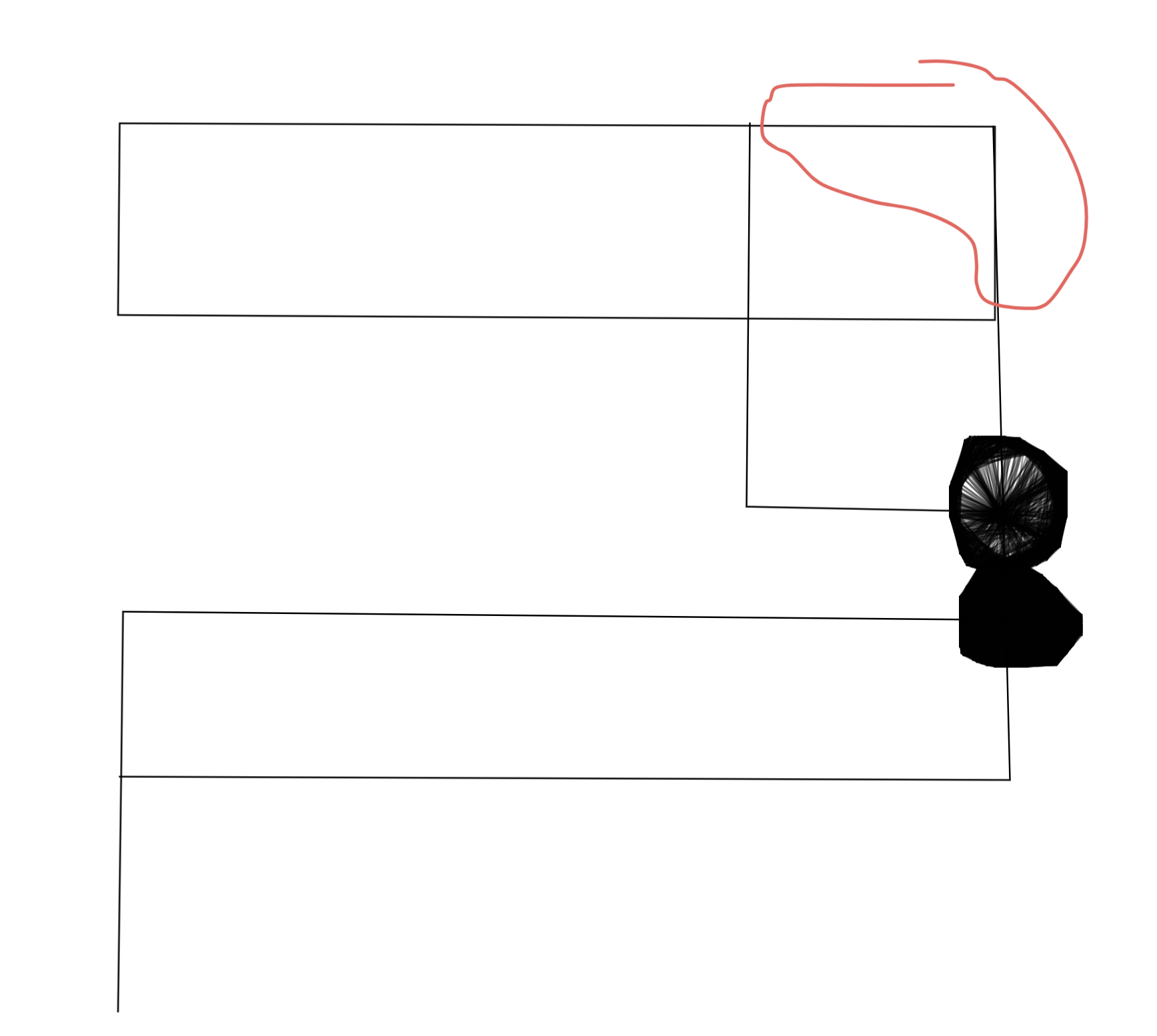

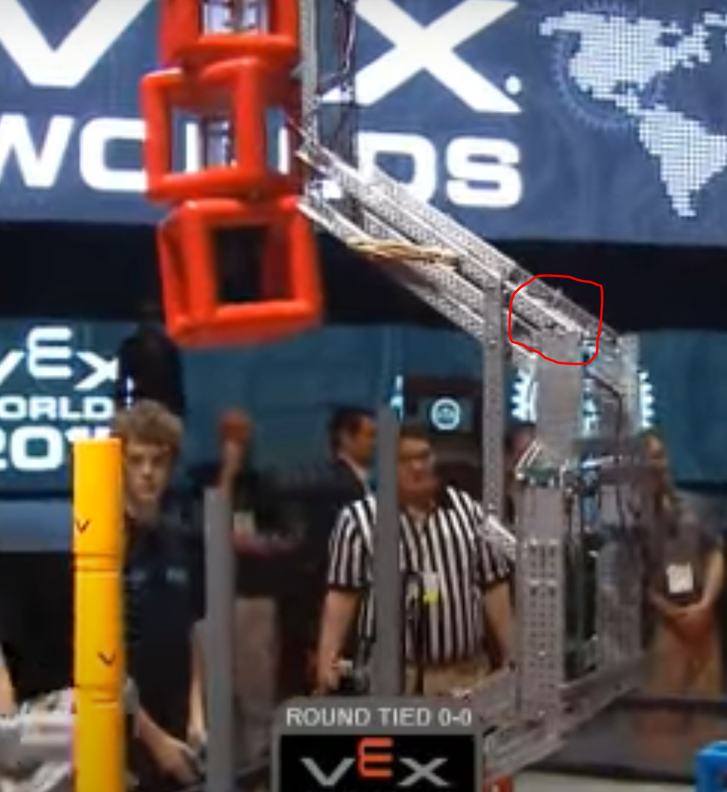

Doing the dive back into the vex archives I noticed a lot of robots using a dr4b used an extension linkage to get extra height to the top 4 bar… I was wondering if anyone knew the reason why these teams (2915, AURA, 118, or even teams like 202Z in ITZ) kept this little extension piece on the top instead of just making the top piece a 6 bar? I have included a crude drawing and a screenshot from AURA in the skyrise world final to get an idea of what I am talking about… The only reason I could really think of was maybe added stability? But not sure…Capture Capture2

But if you just cut off the piece I am referring to it would turn into a 6-bar linkage and have the same height. However, what do you mean by the bottom bar taking up space?
Ooooh wait i didn’t see the middle part

Yeah that’s a stability thing. Having those unpowered contacts with the back really helps with wobbling and rigidity. You really want to have 2 points of contact back there for stability.
Yeah that is what I figured too, I also thought it might be because having 1 really long bar might bend? But that makes sense too, thanks!

I don’t think so, cause if you cut that piece off there would be less moving parts and more likely less friction. See how 62 did their linkage in skyrise for the 4-6 bar method.

Ignoring slop, the extension would create more friction than a DR6B without it, since it adds an extra joint and more weight. This is insignificant though (if built well), and the reduced slop is worth it. I’m not sure where you get the ‘tons of gears’ idea from, since you don’t need extra gears to make larger linkages off a DR4B.

it made the overall linkage much more rigid because the bar wasnt just “floating”, it had a fixed piece to pivot off of. This technique was really necessary in skyrise because of the load and height u had to lift to. The games after skyrise have had nowhere near the amount of stress on the lift if there was one.

For the skyrise robots - it was mainly to get the additional height.
this is especially needed for vertical intake designs.
Ah that makes a lot of sense. I didn’t think about that before.
