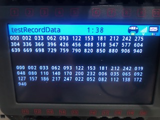

Thank you for any attention to this post. I am attempting to record an encoder in a list. I have written a program that prints the data to the screen and then prints the list. The two sets of numbers are different. I was hoping someone could point out what I was doing wrong.
The screen then prints this:
two different lists, since I am a new user I cannot upload a second image. I will try to upload it as the first comment. Also, I am trying to figure out how to embed code.

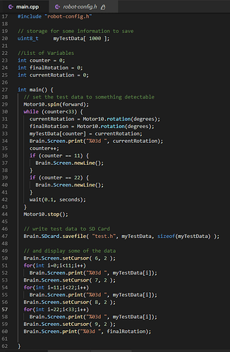

IMG_4335
This is what the list looks like.
myTestData is an array of uint8_t, so values will be limited to the range 0 to 255. Make it int32_t.

When I try to Brain.SDcard.savefile then it throws an error that myTestData is not a uint8_t , is there a way around this?
btw, I am sure it is obvious, but the base of this program was from jpearman.
cast the array to uint8_t *.
  Brain.SDcard.savefile("test.txt", reinterpret_cast<uint8_t *>(testData), lengthToSave );
yea, we should have probably have made that function take a void *.
remember that the length you pass is in bytes, so if you need to save 100 uint32_t values, it would be 400.

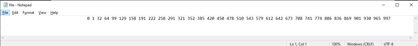

This is the whole code:
Edited program to make it more condense.
And in the next post the resultant file

strlen isn’t going to work properly with an array of binary data, it will look for first occurrence of a byte with a value of 0. If you want to save the whole array, use sizeof(myTestData)
(ok, I see you switched to saving a text string, so strlen will work ok)
