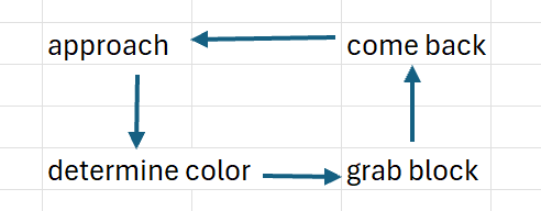

Not new to programming but new to Vex Code IQ and could use some help finding out why, on the third try to grab the correct color block I get a Max Recursion Error on this code. Please help!

That error is when a function calls itself infinitely. Here is an arcticle that might help you.
Your code never breaks. See the crude picture, because this is what your Vex brain is seeing, but there is no way out. It will run forever. It likely runs for a bit the first time you call it. There is a limit to how many times you can call the same function through a recursion which is where a function calls another as VEX_IQ_R12 has provided an article about.
Break this recursive loop and just call it as you need it rather than looping infinitely.
