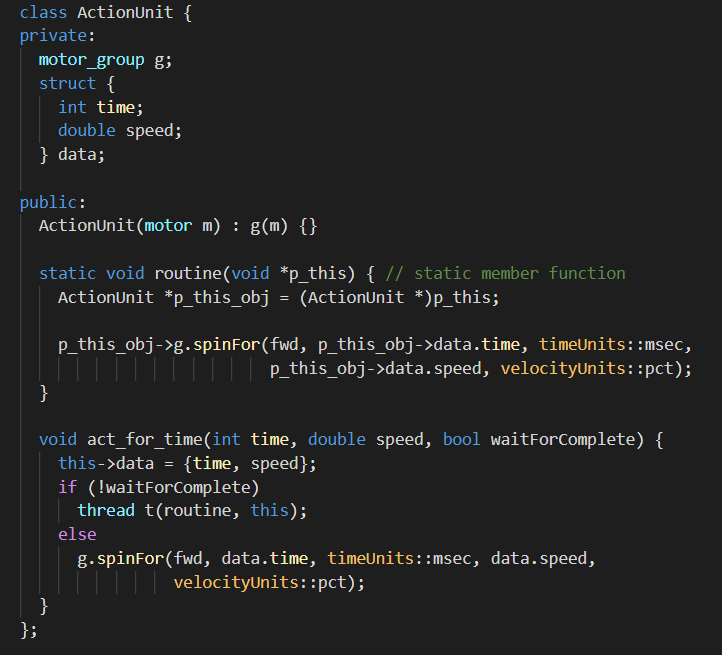

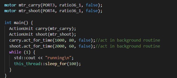

I know that most of the time this won’t be an issue, but I can think a few situations where I would want to have the same macro start on separate threads triggered by separate buttons (an example would be if you release a certain button on the primary controller, it stops a macro but only if it was started from the primary controller)
Now that V5 python support is out, is the behavior with creating threads using the constructor with a void* argument the different than before? (I have since switched to PROS so I’m just curious)
Hm, I didn’t change anything in the C++ classes, and threads are not automatically reused. Python uses a C API to free the thread for reuse, it’s probably possible to use that at the end of a thread in C++ but I never tried it. To be honest, it’s not something most of our customers really care about so I was reluctant to change too much in the scheduler and potentially break something. I’ll try a few ideas tomorrow and see if it works for your use case.
int f(void* ) {
static int k = 0;
cout << "id: " << this_thread::get_id() << " " << ++k << endl;

I try to define a class named ActionUnit, which has a motor_group member variable inside. ActionUnit can be instantiated to intake, carry,shoot ,etc. And ActionUnit has a function void act_for_time( int time ,bool waitForComplete ), which can make an ActionUnit instance to spin for some time in a background thread.
below is an example of ActionUnit that is simplified…
#include "iostream"
#include "vex.h"
using namespace vex;
class ActionUnit {
private:
  motor_group g;
  struct {
    int time;
    double speed;
  } data;
public:
  ActionUnit(motor m) : g(m) {}
  static void routine(void *p_this) { // static member function
    ActionUnit *p_this_obj = (ActionUnit *)p_this;
    p_this_obj->g.spinFor(fwd, p_this_obj->data.time, timeUnits::msec,
                          p_this_obj->data.speed, velocityUnits::pct);
  void act_for_time(int time, double speed, bool waitForComplete) {
    this->data = {time, speed};
    if (!waitForComplete)
      thread t(routine, this);
    else
      g.spinFor(fwd, data.time, timeUnits::msec, data.speed,
motor mtr_carry(PORT3, ratio36_1, false);
motor mtr_shoot(PORT4, ratio36_1, false);
int main() {
  ActionUnit carry(mtr_carry);
  ActionUnit shoot(mtr_shoot);
  carry.act_for_time(1000, 80, false);
  shoot.act_for_time(2000, 60, false);
  while (1) {
    std::cout << "running\n";
    this_thread::sleep_for(100);
