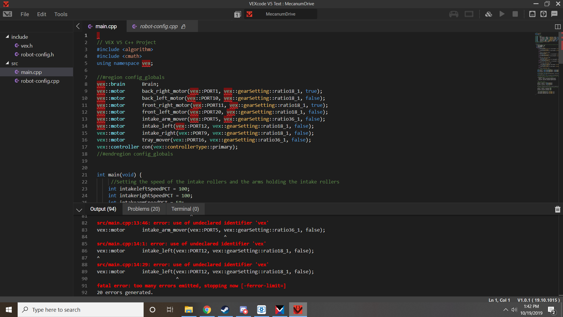

Red highlighting when transferring code
Okay, so I am having issues when transferring my code to vexcode from VCS. Every “vex” is highlighted, as well as the tilde at the top. Also, is there a template for where to put driver control and autonomous code? Thanks!

Ok, finally got it to recognize vex by putting it under vex.h

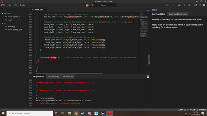

My issue now is how is it putting errors in the holonomic code @John_TYler put out. I put the errors vexcode highlights in quotation marks:

The “std” at the bottom, and the “sleep” and the ending brackets
It’s putting errors in the code you copied because you took out the #include statements that make them work.
Ok, thanks! (20chars)
