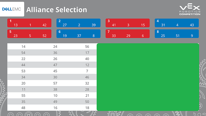

Redesigned Alliance Selection Screen
I am not a fan of the alliance selection screen built-in to Tournament Manager. I consider it to have a number of flaws, including, but not limited to, lots of wasted space, unnecessarily small font sizes, and lack of a focal point for attention.
As such, I decided to develop my own alliance selection interface, intended to alleviate many of the shortcomings of TM’s implementation.
Before I continue:
No, my system does not interface, interfere, or in any other way interact with Tournament Manager, its files, or its network packets.
We piloted my new, custom system at the Arizona College Prep - Erie VRC Qualifier.
You can see it in action, starting at timecode 5:22:00, here: youtu.be/XDoyDA_2nMA?t=19320.
(The live camera feed was an intended supported feature of my system, though other software is required to actually implement the feed.)
I would appreciate any feedback on my system. If sufficient interest amounts, I may even release it publicly in the future.

It’s designed in a modular way to accommodate any number of alliances and any number of teams per alliance (within reason – I have neither implemented clamping of these values nor tested unreasonable values).

My system, as it stands currently, is built as a standard webpage. HTML/CSS for the frontend; JavaScript handles the logic and modifies the HTML appropriately. As a result, my system can be used on any device with Chrome installed (I used new web standards not implemented in other browsers).

  1. VEX Robotics has a whole team of people who are responsible for graphics and media (game/company logos, assets, all the banners you see at Worlds, a million other things that I don’t know about, etc). They design all of the the audience-facing screens, including the current alliance selection screens. Thus, if you have comments or complaints regarding those screens, please do not send them to us as there’s not really much we can do about it. My advice on topics like that is to bring them up to your RECF representative and they can forward it on through the right channels.
The current designs have been in place for a few years now and I do think at a minimum there’s some tweaks needed. The alternate alliance selection screen here looks very very similar to a proposal I saw from @Karthik a year or 2 ago that I believe was posted on chiefdelphi.com (can’t find it now due to the new forum in use there). I think having a screen that allows video to be shown as well as the alliance selection data would be a nice improvement. However, screen designs have a number of requirements that need to be considered, several of which aren’t addressed in the sample here. This includes things like including appropriate branding/sponsor recognition and attention to title-safe areas among other things.

I believe this is what you were referring to. The image he provided doesn’t seem to display properly on that page, so here it is as well:

Yeah, that’s what I was thinking of. I thought it was closer to the design in this thread than that though. Pretty sure I’ve seen something similar somewhere. Anyway, I do like the general idea presented here.
