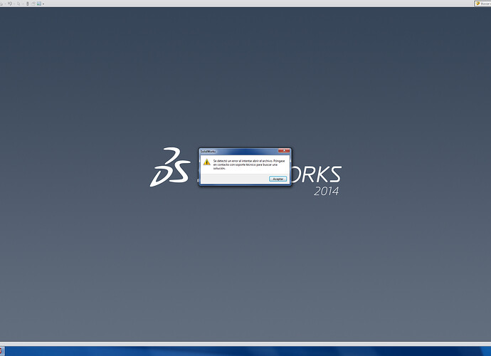

Thank you for sharing!! I downloaded yesterday, but when I tried to open some structures in solidworks it indicates error to open the file, a lot of files with that error, may I know what version of solidworks did you used?
I used the 2015 version.
Can you post a screenshot of the error?
Right now Im not in the pc, but it showed me a window with the text: “Error oppening the file” and also I tried to open it with Autodesk Inventor and the problem persist

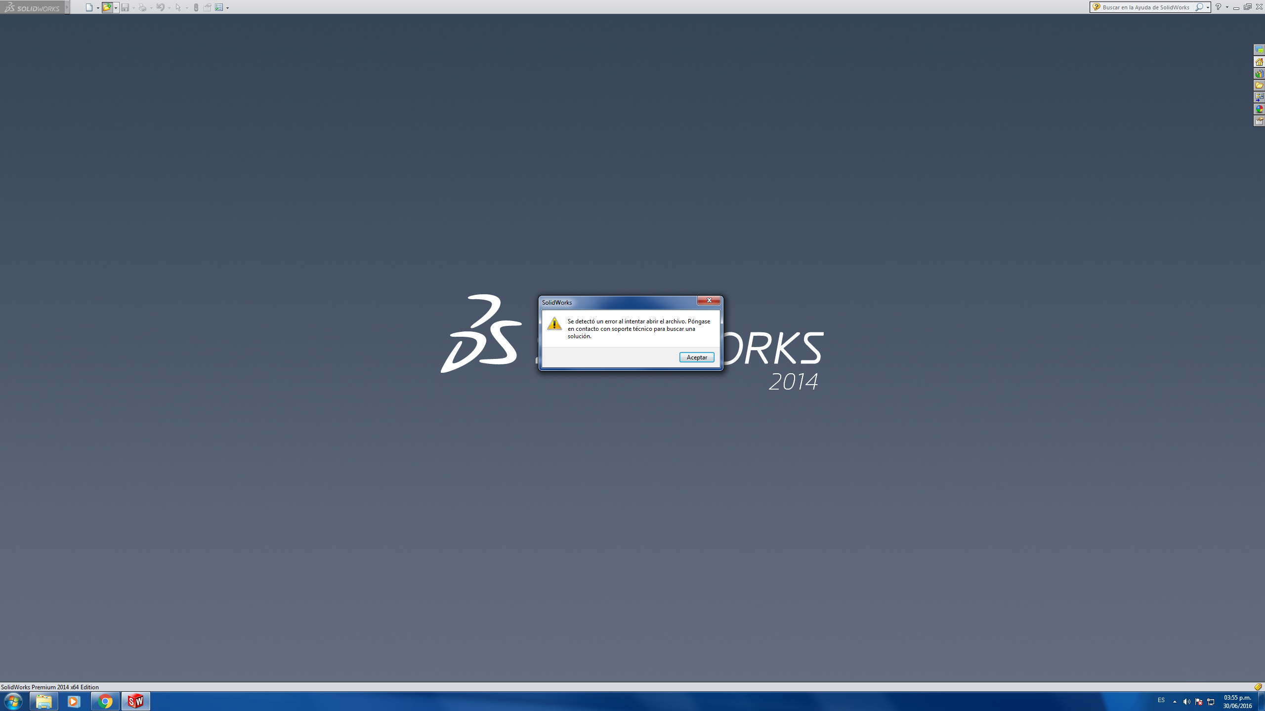

Edit: Anyone else getting this? Imgur: The magic of the Internet
Perhaps these are SW 2015 files.
This is a great resource for the entire community. Thanks for creating it!
If you have only the 2014 version, you can go to the Team Virus web page here%between% and get the structure parts in SW2014 format. SW made a change in 2015 & 2016 that is not backward compatible to SW2014 :frowning: . Many other VEX parts are availble in 3d Content Central
My windows only says that an error ocurred when I try to open some files, I think that I need try to download the original ones and modify it, Thank You so much! :smiley:
yes, thats my problem troo, iI think that could be because the version of solidworks, NattyMan0007 says that he used 2015, I will try it

Thanks a lot! The problem was the Solid Works version, if you dont want problems, you must have the 2015 version :slight_smile: very usefull library, thanks to all that make it possible :wink:
