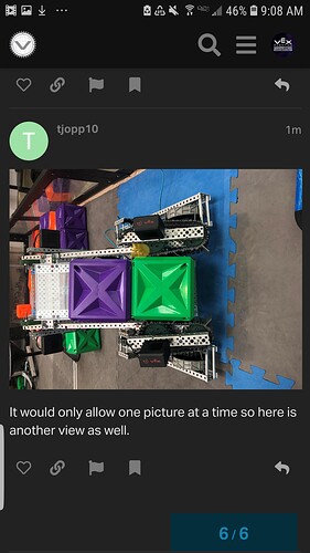

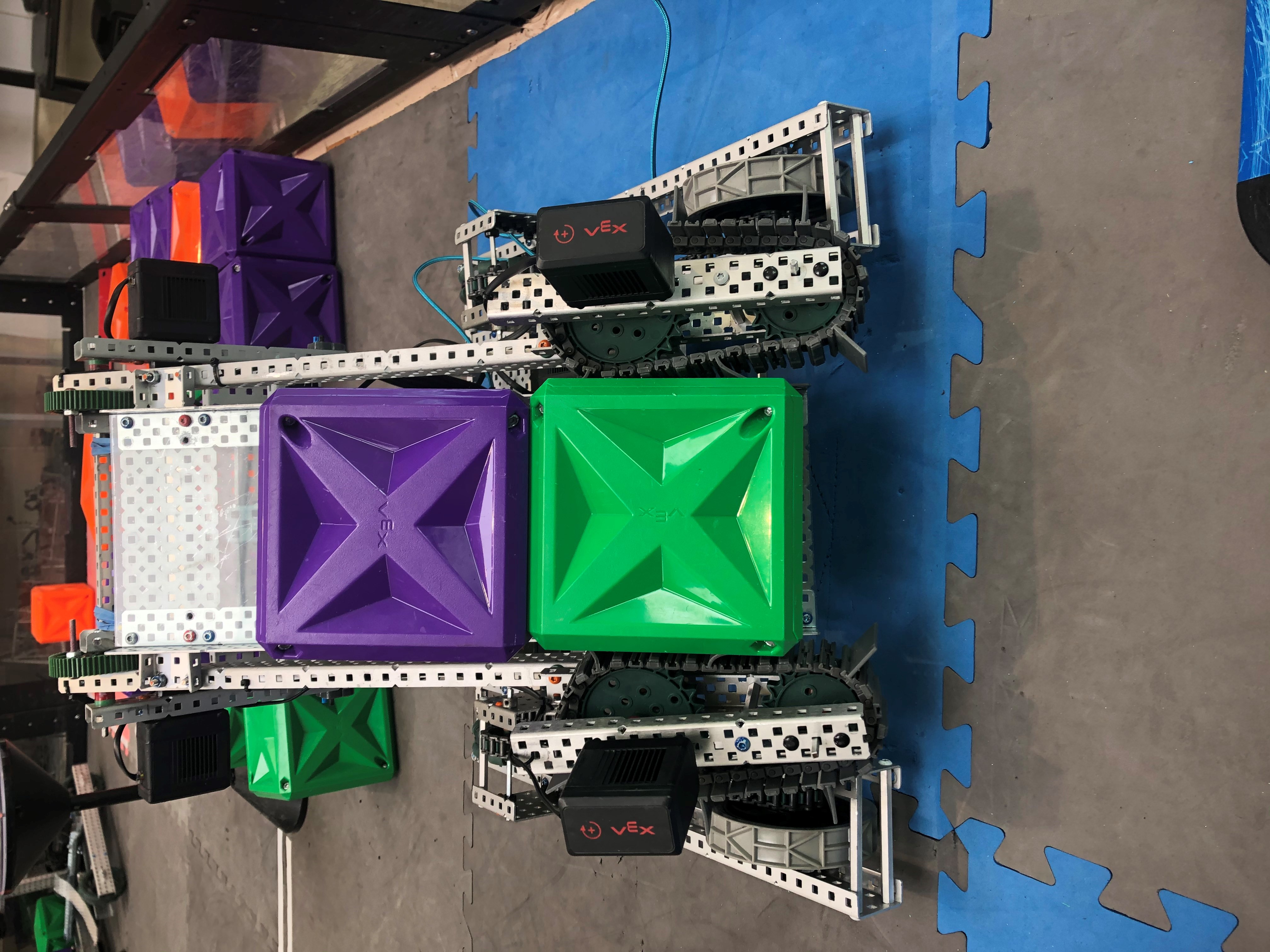

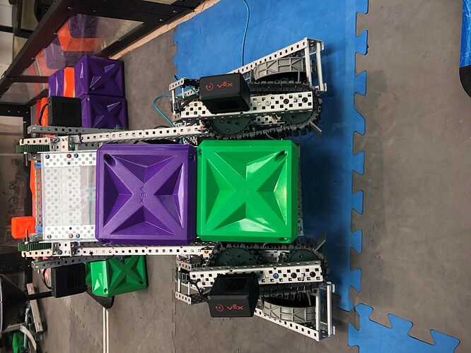

Here is a picture of what it is like. The intakes are not on pivots, just the arm that raises them currently. The only problem with raising the arm to be parallel is the cubes will fall out.
y
It would only allow one picture at a time so here is another view as well.

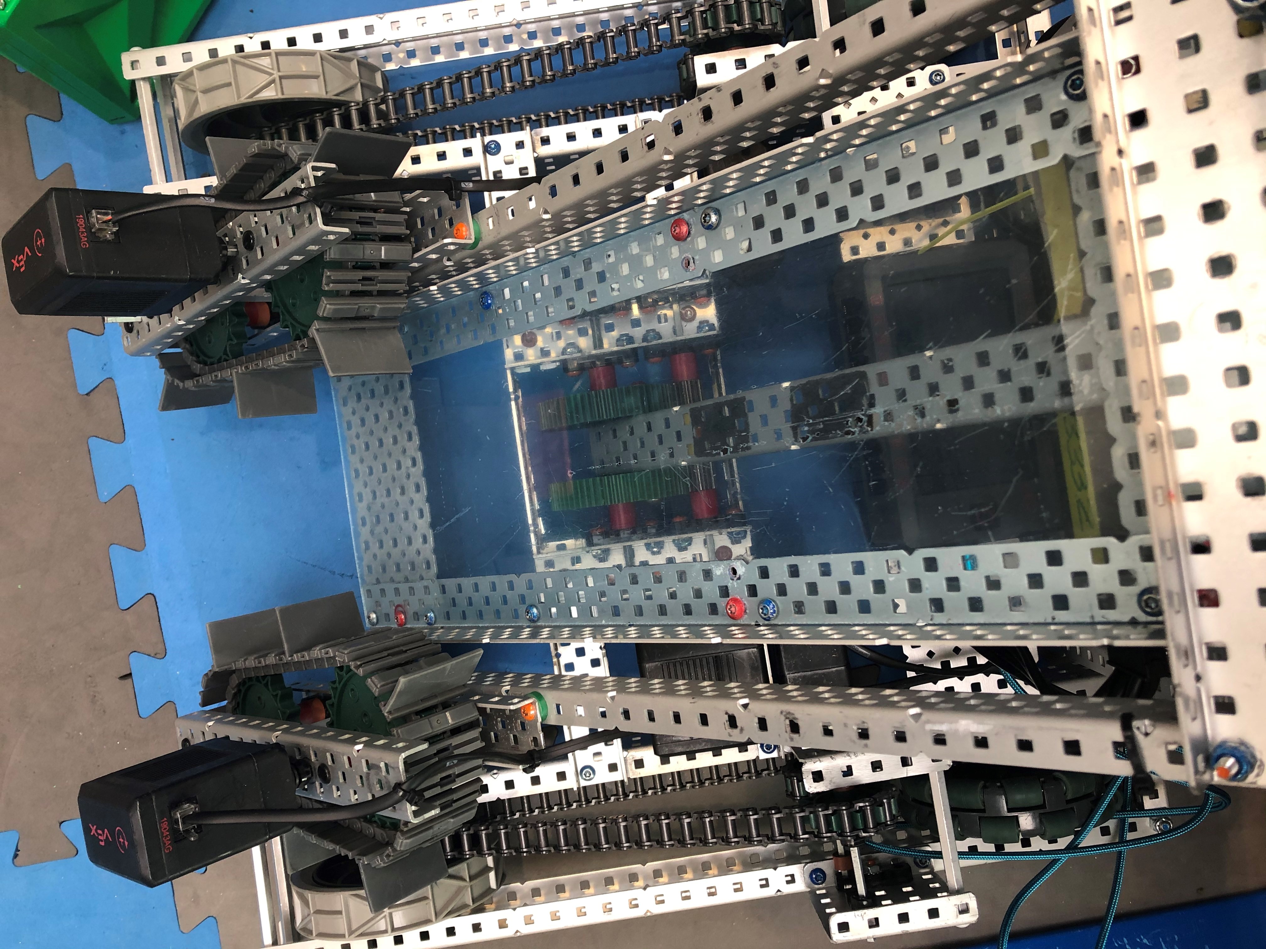

20191123_090904
Are they connected with the one point of connection that I highlighted?
Also, did you paint your screws?
Those are probably the color coded screws from https://www.robosource.net/
Yes, they are connected at that point, but it’s not a pivot point just a straight screw.
And yes, they are the color coded screws.

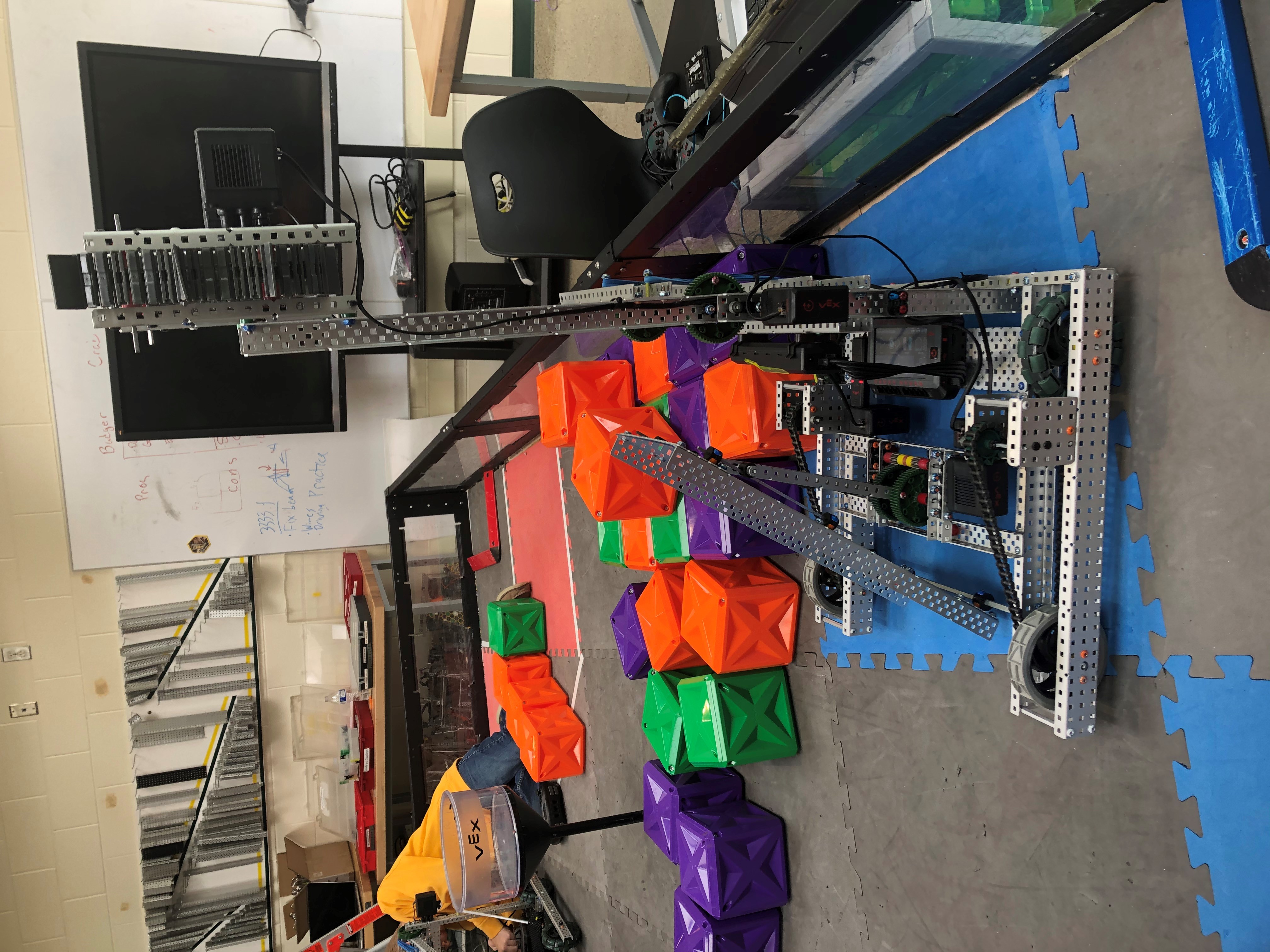

Can you send a picture if the robot from the side without any cubes, but the lift rased to it’s highest
a
If you drive like normal to just outside of the hole zone, and then do this, and then push the cubes in, what happens?
If we raise the lift, the only thing holding the cubes onto the tray will be the ground because they would slide out the bottom. So, when I would go to drive forward the cubes catch on the ground and ultimately fall out. Maybe a piece of metal to hold cubes could fix that?

a video could help us understand your issue. from what I see, you should be able to place stacks. our intakes stick out much farther, and we can place just fine.
