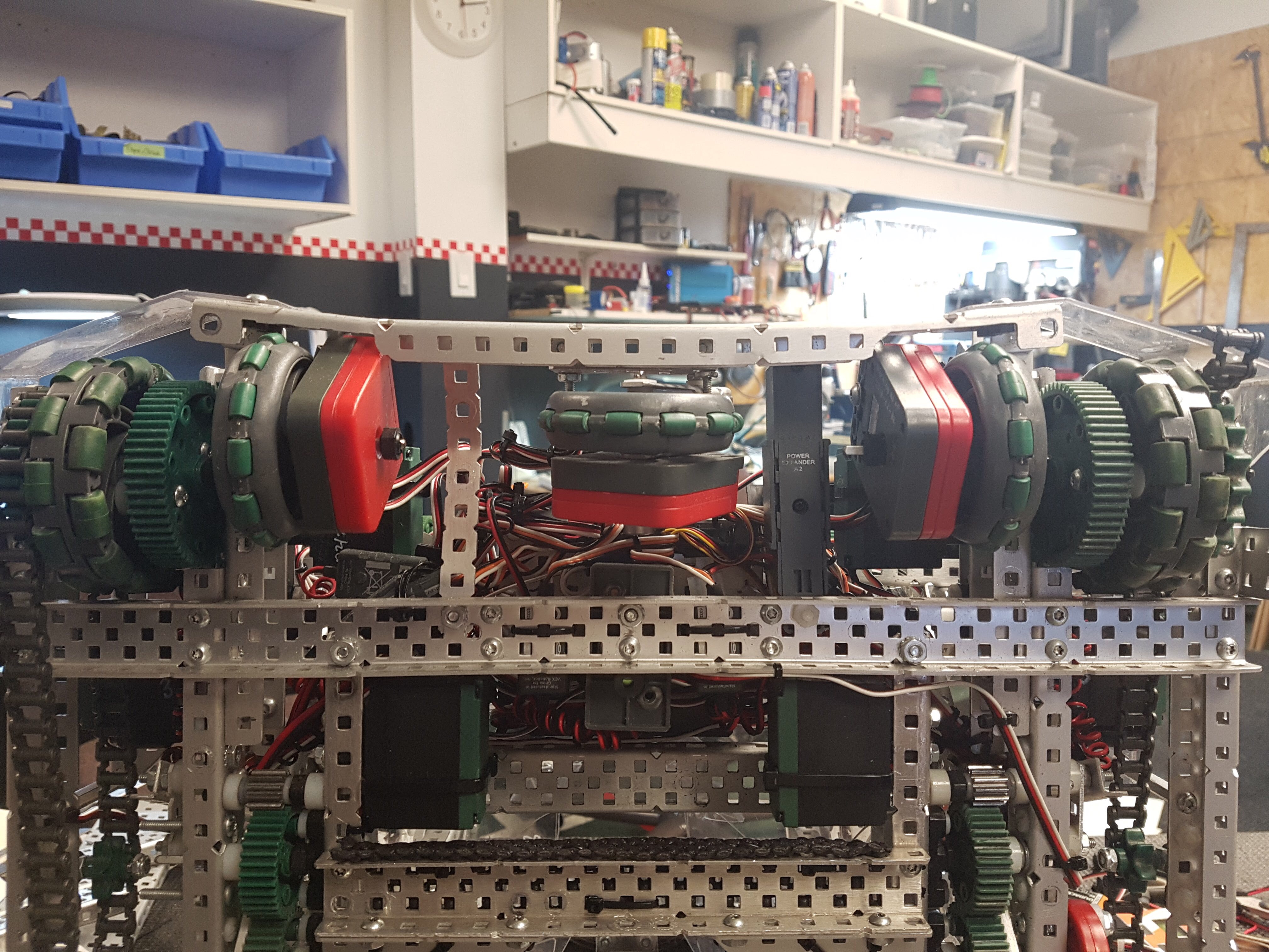

To achieve the highest possible driving accuracy you would actually want 3 encoder wheels. This can be seen on 5225A’s world champion ITZ robot image
