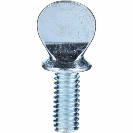

As @callen has educated me, It’s definitely a term in some amount of use, but it is likey a colloquialism (love that word!) or regionalism. To your point about spades not being flat, here’s a spade-head screw, which is entirely unrelated to a standard slotted screw or screwdriver:
This is the “spade-head” associated with screws with which I am familiar, and you can understand the derivation of the name. For a screwdriver meant to fit into a standard slotted screw head, the silhoette of the business end does resemble the silhoette of a spade. Another possible connection is that a “spade lug” wire termination is a straight connector. Like this:
