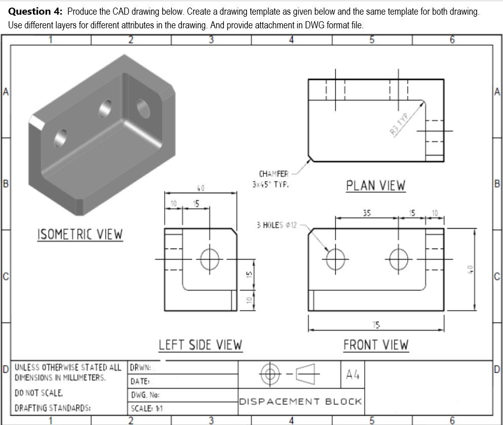

Here’s an example of how a CAD drawing pulls in all your sketches and even assemblies into a cohesive, readable file. This is supposed to help you understand the geometries of your parts so you can more easily manufacture and assemble them. It’s also just a good way to get a birdseye view of what is actually going on instead of what you think is going on but are unintentionally biased against (from things like parallax and measurement error to even manufacturing error).

I think the picture you pulled up of a drawing file kind of shows how it can replace phyical sketches in a way. I know there are some flaws in only using CAD but CAD can do everything a sketch can do and more. CAD only mean computer aided design so that doesn’t lessen what you can do. You don’t have to specifically use the official vex parts in CAD and you can edit the original vex parts to be more accurate to your physical version. CAD also can be 2-d and sketches can all be done on the computer and not physically. Although to be honest a lot of this goes down to preference and you definitely brought up a good point that it can be good to have variety but when used right i think it is a good way to have a notebook exact and more professional (if you like it that way). ( Ill have to add that a lot of this is opinionated so there might not really be a right or wrong here)
