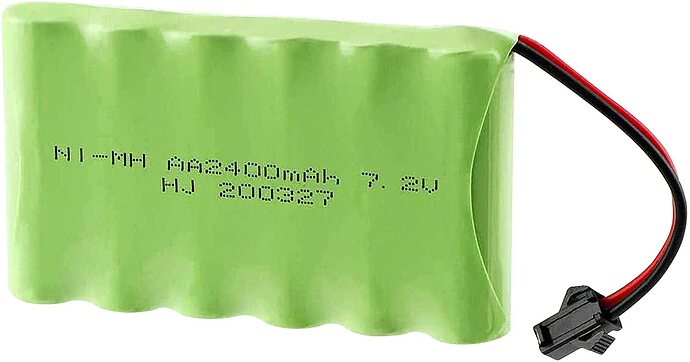

He have a bunch of Gen 1 batteries that are about 5 years old and can’t hold much of a charge anymore. Given the Gen 2 battery delays, we are in a tight spot for batteries that work come the fall. We wanted to see if anyone has successfully opened up the rechargeable batteries and swapped out the battery pack with a new one and were able to reuse? The disclaimer, this is for practicing only. We have opened three of the battery packs without breaking the case and have the tools to solder and do whatever. So curious if anyone has had success doing this, things to look out for, specific battery pack order, ect. (I searched the forum for past posts and didn’t see anything, but also assume I am not the first one to ask / try this)

Below is the battery pack that we purchased that we’re going to test out on one first.

Please don’t post any details or pictures on the forum. We do not need a 13 year old trying to do this and getting it wrong. There is at least one sensor in the pack the charger needs to read, and it has only been tested with the batteries we use.
No, what @Foster ment was don’t do this. Taking apart prepackaged battery packs is hard. They are welded with harder metal straps. Which means taking them apart is harder than you think. As @jpearman noted there are sensors taking stock of the battery, they expect certain types of cells.

Not going to recommend that. If you are desperate for a battery, grab the $10 case a 6 AA batteries and use that. Frankenmashing battery packs is not recommended.
While trying to rebuild the IQ Gen 1 battery pack is a bad idea, trying to rebuild the packs on the V5, EXP or IQ Gen 2 batteries is a REALLY bad idea.
IQ Gen 1 uses NiMH cells, which have much lower energy density, but are more forgiving of mechanical abuse.
V5, EXP and IQ Gen 2 all use some variant of lithium cells. If you are trying to open a battery pack with lithium cells and manage to puncture one of the cells, it can quite literally burst into flames (while spewing highly toxic fumes).
