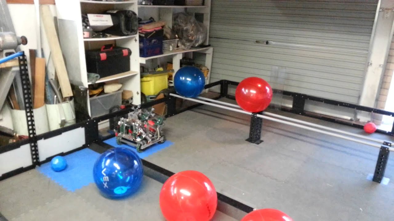

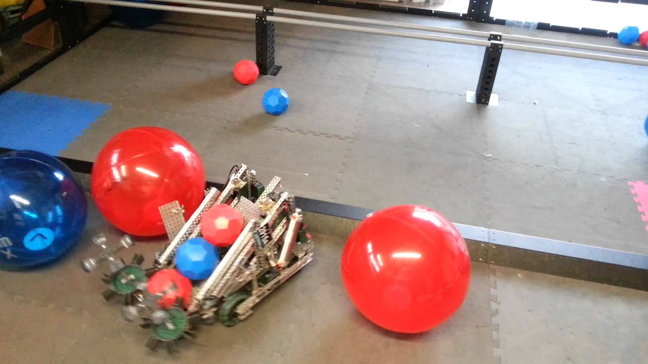

Here are a couple of auton programs using it:
If you look up the games from 2014 worlds you will probably see some others if you are interested.
