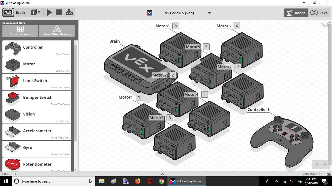

My team and I have created a Vex V5 code for a reverse four bar lift robot and we are experiencing two issues,

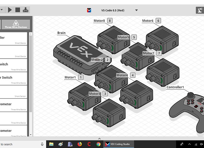

A. The two rear dive motors (Motors 3 & 4) are stopping completely when the program begins and do not move even when attempting to manually force them to turn.

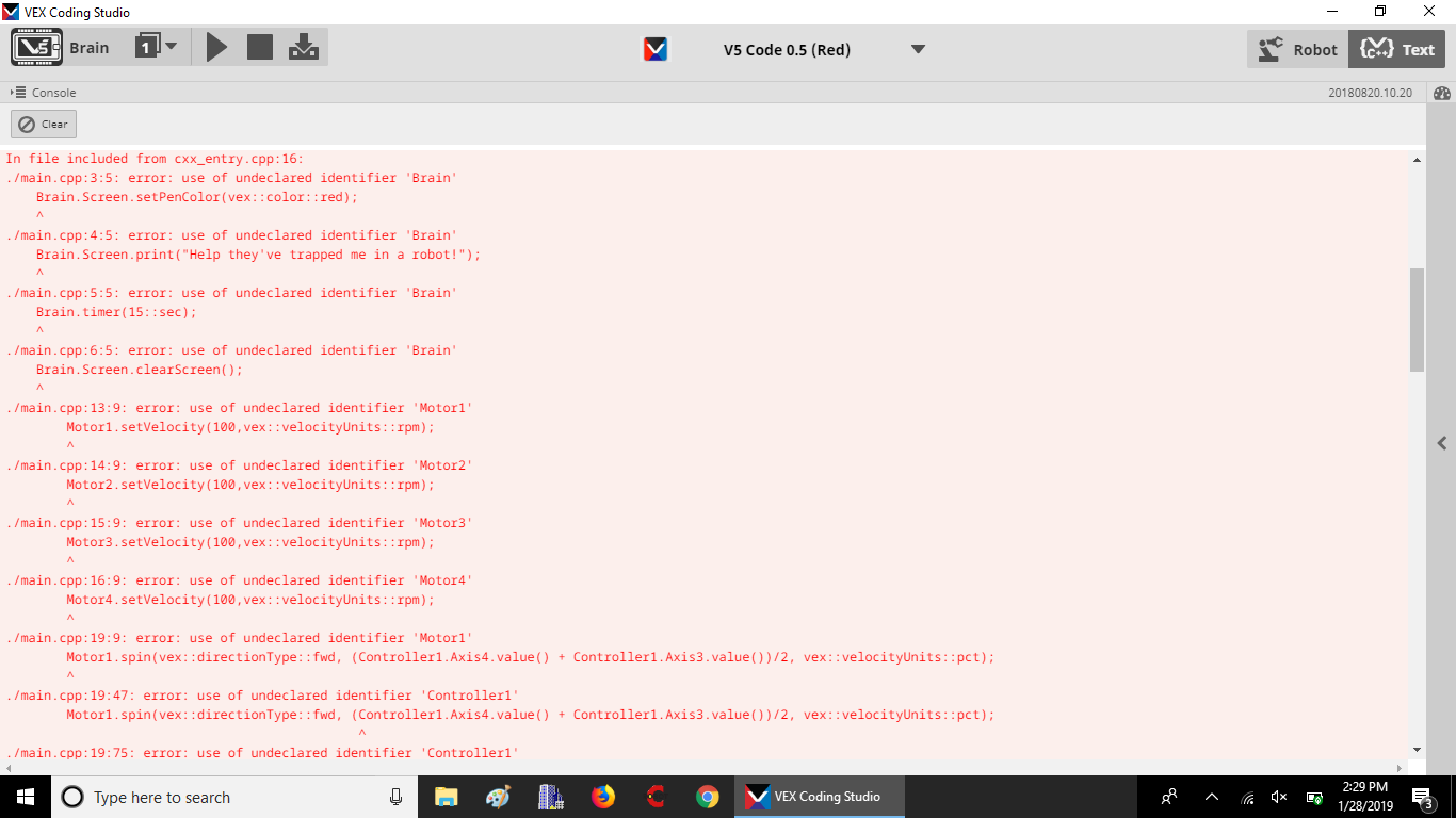

B. When complying, the program says that names like “Motor 1” and “Brain” are unidentified and I cannot understand why this would happen.
Below is my code in its entirety and attached is an image of the motor set up and the compilation errors I am experiencing. If you could help me in any way I would be grateful as we have a competition coming up soon (Sat. 2/2/19) and need to have this done as soon as possible. Thanks.
My team is the Cougar Renegades (42748C), and we compete in upstate South Carolina.

Motor set up

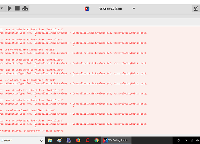

Compilation errors

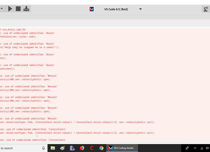

Compilation errors Cont.
Do you have #include “robot-config.h”?
Have you competed before?
Thanks that fixed it.
Yes we have competed before, but not with the V5 system.
A. Your program won’t download with compilation errors. Whatever it’s doing now is not related to the code that you’ve posted with compilation errors.
B. You appear to have deleted
#include "robot-config.h"
from the top of your project. Would be my first guess. Whatever code was defining your motors has been removed. [You fixed this while I was typing.]
