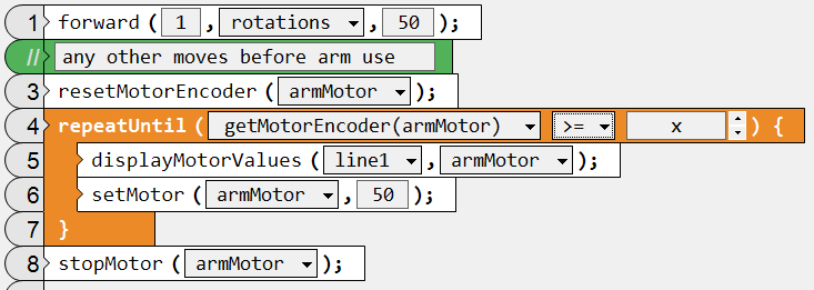

Is there a way to reset the arm motors to 0 at the beginning of each segment of an autonomous program ? We are using touch sensors to begin each segment. We have tried the resetmotor encoder as a stand alone command but it does not seem to work. We are not sure if the command needs to be in a loop or if there a particular way that this command needs to be coded. Any help would be appreciated.

You need to tell it ehich motor to reset so it would be resetMotorEncoder(motorName);

Are you going for something like this? This would be a segment inside your touch sensor select code.
27%20PM
On the LCD you should see the numbers start at zero.
Of course, must use correct “greater than or equal” or “less than or equal”.
And need to determine “x” by trial and error.

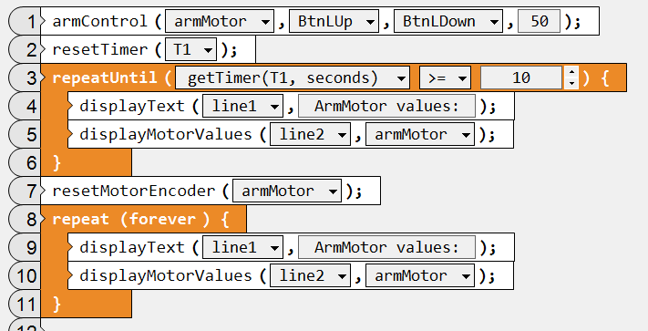

Or to find “x” you can put bot (and arm) where it would be in your autonomous, connect Controller and run something like this as a separate test program:
44%20PM
During the repeatUntil 10 seconds you can use buttons on Controller, watch numbers on the LCD. Before the 10 seconds are done, move the arm to where you want it to start .
Then the reset should zero the encoder number.
Then use Controller buttons to move to where you want arm to finish. Number on LCD is “x”.
