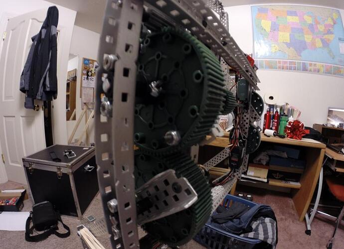

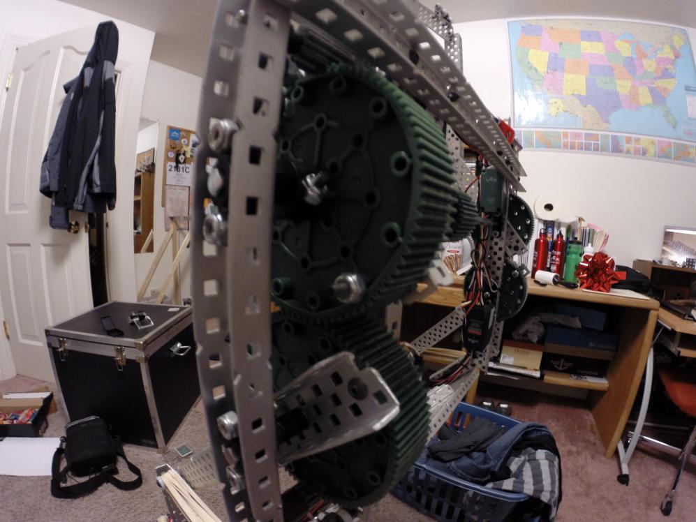

Let me tell you some things that I’ve done on our reverse double six bars. Double up the high strength gears attached to the arms. This both increases tooth contact and reduces slippage while also spacing the two arm sets a little further apart. I find that this extra half inch of clearance is extremely helpful. Doubling up the gears, unfortunately makes it so that you cannot use a 2-inch bolt as the axle. Fortunately, Vex came out with high-strength axles for this year. In my opinion, these are better than using bolts. Simplicity in moving parts is key to strong, reliable systems. Since you are using a 1:7 ratio with only 4 motors, place the pinion gears (driven by the motors) on the top and bottom of the lift arm 84-tooth gears. This minimizes friction as well as keeps all the gears meshed together. As always, make sure everything lines up well and axles spin freely before putting rubber-bands, motors, or any weight on the lift. On the high strength axle bearings, we drilled them out to a slightly larger size so the axles would spin more freely. When I say slightly, I mean the next size of drill bit up that is as close to the diameter of the inside of the bearings. You only want to make them a tiny bit wider.
Here is picture showing most of what I have said.

What are thoughts on this gearing arrangement? Ignore that it is a reverse double six-bar. I was experimenting.

a lot of excess gears I think. it will still work but I think the best way is to gear the top and bottom lift sections together directly and bar the top gear up to power the second section. its not a bad way to go though.
What is your intake, because that actually effects your dr4b a lot not just in the gearing but the building.
