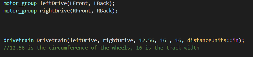

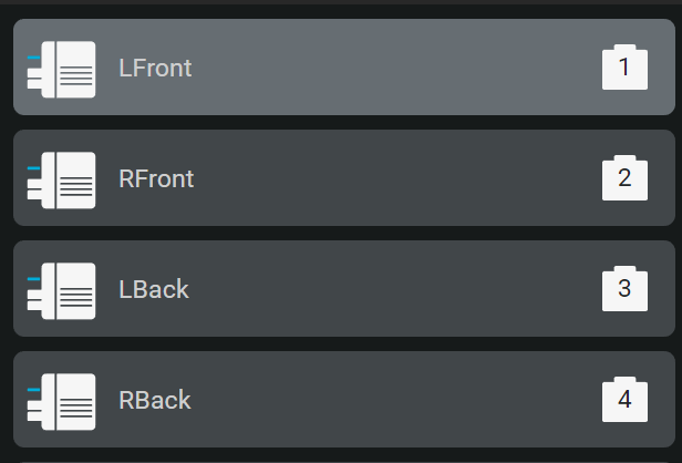

So you can do it physically like suggested above. BUT you can also do it through programming. I am assuming that you are setting up the drivetrain through the robot configuration wizard.
You can set them up manually however and when you do it that way you add each motor individually to the drivetrain and can reverse it before putting it into the drivetrain.
Here are some examples:
Note that when you set the drivetrain up manually sometimes the drivetrain commands won’t autofill, so you just need to remember what they are.
