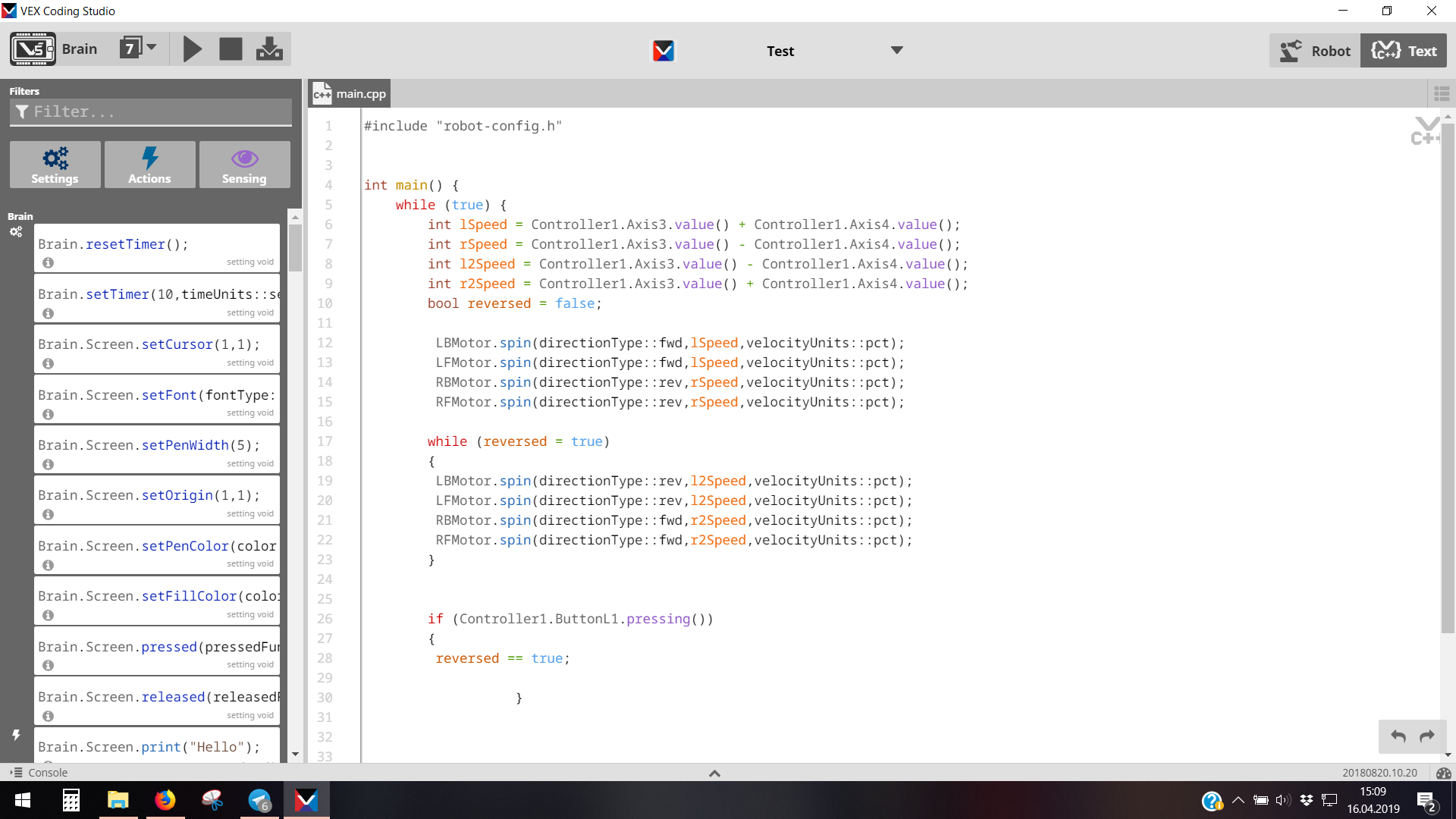

thank you so much, that might help. I`m writing code for V5.
grafik#
thats supposed to work as a switch, but it dosen´t.
Your while (reversed == true) loop doesn’t exit, so once it gets to be reversed it stays. Make it an If(reversed== true)

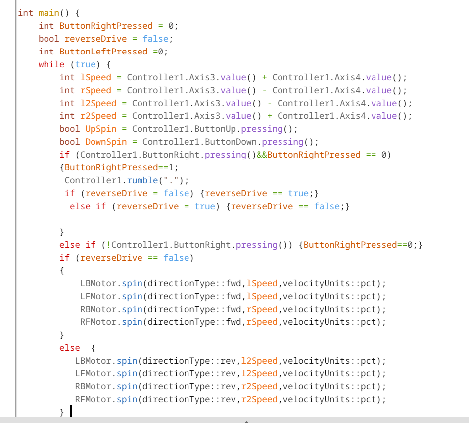

This afternoon I got pretty close, switching to reversed already worked, but switching back to normal didn´t work yet, because “true” wasn´t exactly defined.grafik

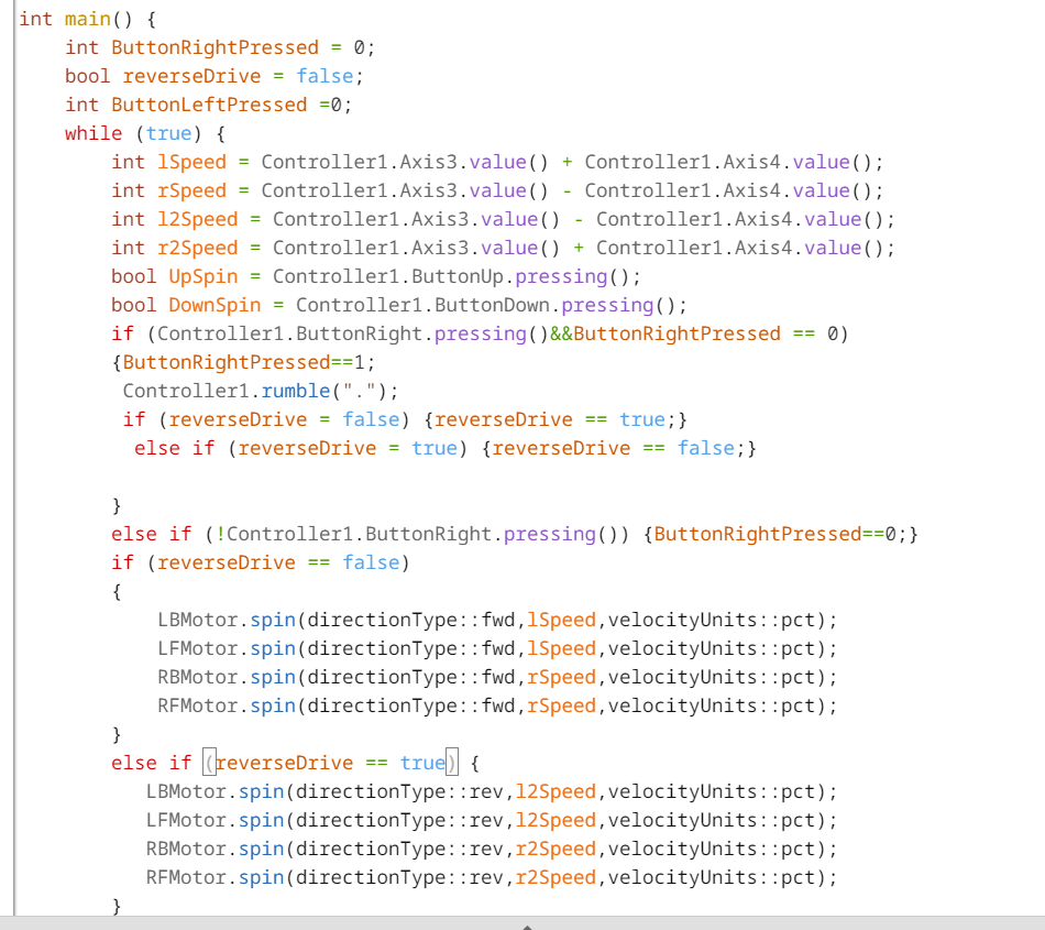

grafik
This is what I´m going to try next, “else if (reverseDrive ==true) { reversed driving code}”. The “reversed drive == true” might get the switch working…
You seem to occasionally be putting assignment operators, =, into conditionals instead of comparison operators, ==. I’m betting a lot of your flow control logic problems are stemming from that. To boot, you’re also making the opposite mistake in some cases, too.
Actually, one of the if...else if blocks where you are making this transposition can be replaced with a single reverseDrive = !reverseDrive; to handle toggling. The places where you try to ButtonRightPressed==1; or ButtonRightPressed==0; do need to be changed to an assignment operator =, though.

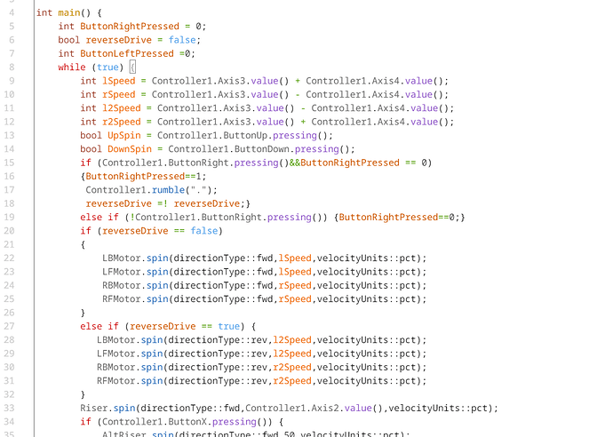

I did it!! It´s working! Thanks everybody for your help, you are much more helpful than our other coder. But I learned a lot.
