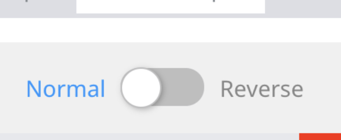

In regards to programming, put a negative in the motor power. But if you mean reverse it as in settings, open the motors and sensors setup, click the motor, and check this:

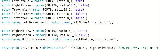

Our two front motors are reversed, and can’t be fixed.

configure each motor either using the graphical config (using the reverse toggle) or manually by adding “true” for the reverse flag in the constructor. This is all completely independent of the drivetrain which assumes motors are configured correctly.

I’m a bit confused by constructer
Here is a picture if that helps

The motors are put in backwards.

Ok, so let’s assume that your port 9 motor is the one that’s put in backwards. See the line motor rightMotorA = motor(PORT9...)? Take the true at the end and change it to a false.

The picture shows right motors are reversed (the true flag) also the leftIntake motor.
or are we misunderstanding your question, to have a motor spin backwards send negative velocity values whilst keeping direction set to “forward”
