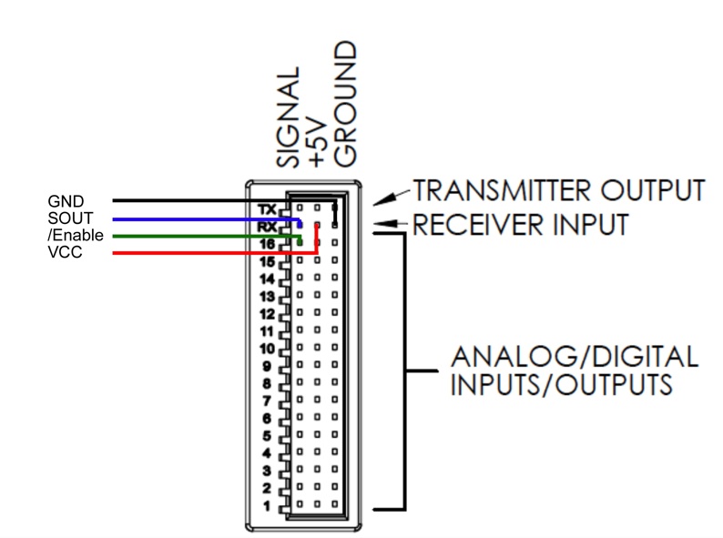

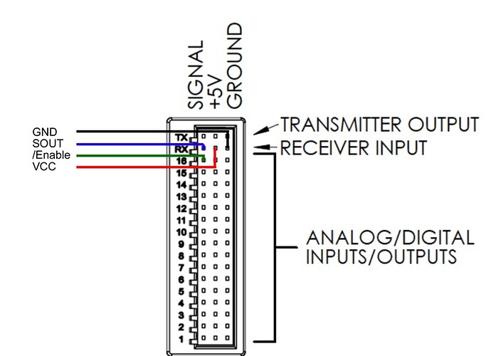

Would it be possible to interface the mentioned RFID reader with the PIC Microcontroller V0.5?
I was thinking it would be possible to connect it to a digital output for the 5v power supply and use the RX port for the sout. It would require some extra coding. But from what I have read about the Tx/Rx interfacing i think it is possible.
What are everyone’s thoughts?
Thanks
Yes, should not be a problem.
The RFID reader we talked about before only has serial data out, so it will go to the RX input on the PIC. Use one of the digital port lines as an output for enable. Something like this.
[ATTACH]7374[/ATTACH]
The baud rate is pretty slow so the PIC will have no problems reading the data.
Thank you, this answers my question perfectly!!
