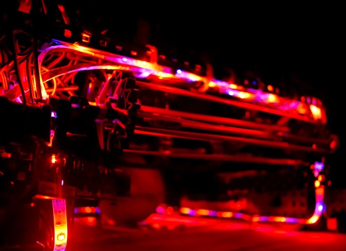

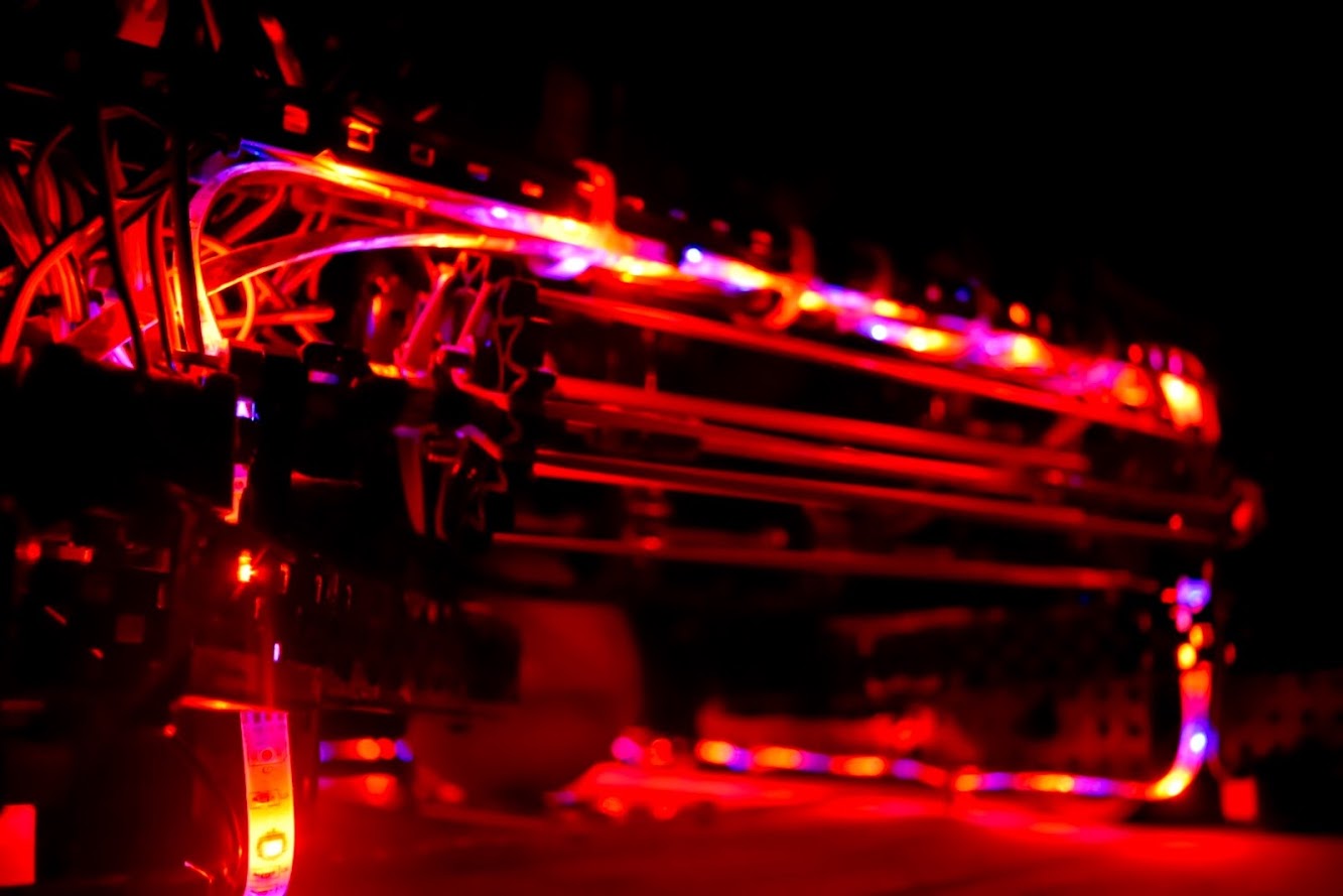

Well I’m fairly sure it was legal since it passed many inspection tables, but I found a cheap RGB LED strip that was powered by USB with a inline programming chip. I cut the USB portion off and soldered the power leads to a PWM cable. Then plugged it into a sensor port on the cortex. It works because the cortex outputs 5v out of the digital and analog ports.
I mean it was iffy but nobody ever questioned it, I even got a response from Karthik on here explaining it shouldn’t be an issue. But here’s a link and a picture.
