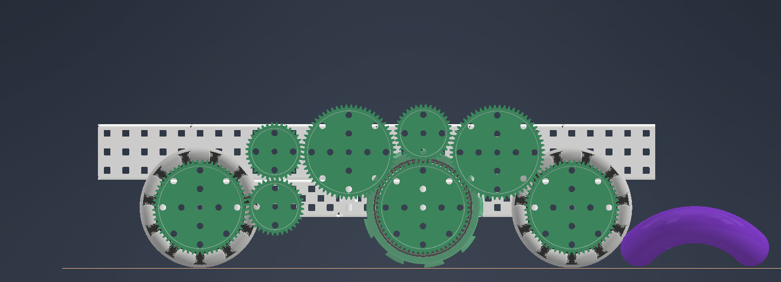

Do you guys think that this will have enough wheel clearance to not get stuck on rings?
It’s supposed to be a 360 rpm 3.25" 6 motor drive.
Also, yeah, I realize that it would be crazy high on friction. I wanted to design a drive with enough clearance, and realized that I could mesh 60 tooth gears like that, and designed this kind of for laughs. I wonder if It would work though…
A good rule of thumb is that rings are 1.67 inches tall, the platform has a 0.5 inch lip, if you wanna build a drive that can balance on the platform and deflect rings, give your drive a 1 inch or 1.25 inch clearance. That is of course if you wanna balance, if not you can make it as low as you want
