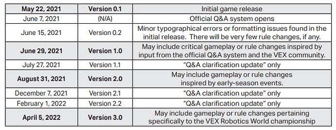

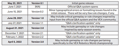

Expect that most current Q&A not to be answered on robot events given that GDC will issue new Game Manual July 27… As indicated this release will be Q&A Clarifications.
August 31 wil be final release for season until next release of Game Manual in December.
