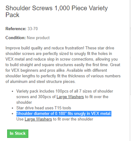

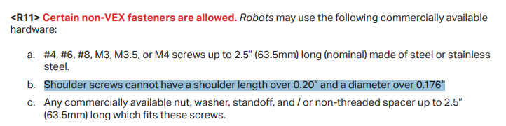

Robosource Shoulder Screws are Illegal?

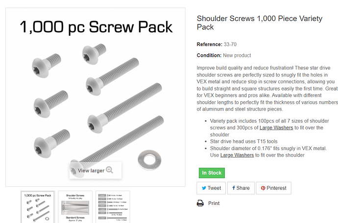

Update: We back boys
For those who may not have seen the relevant conversation on the vex discord, Robosource.net just updated their website with a new size that is legal.
(Screenshot taken 5:30 pm EST 6/28)
Kevin from Robosource said that this new number is more accurate and the “0.18” figure was due to rounding:

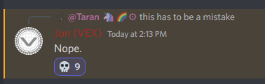

As it seems that this may have been an intentional rules change from vex:
I wonder if vex might further reduce the limit for some reason. I have no idea why they would want to disallow Robosource shoulder screws but this wouldn’t be the first rules change with unclear reasoning.

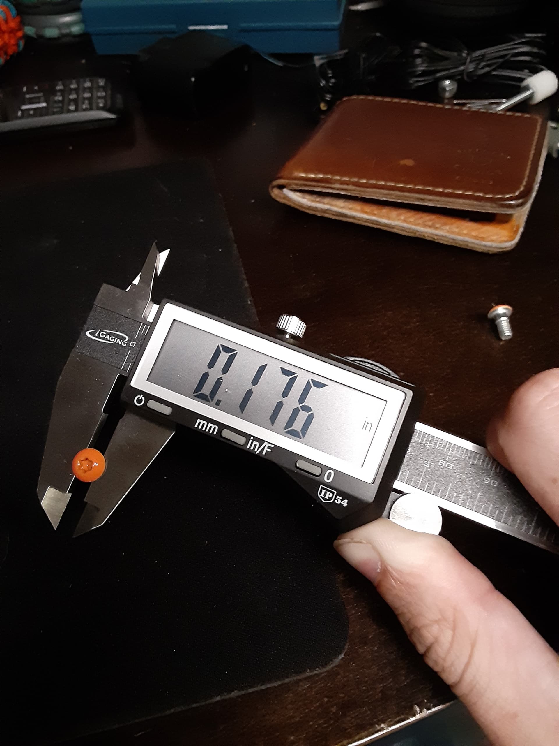

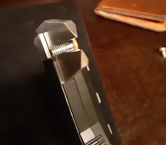

Just to confirm:
Measured about a dozen, 10 within allowable size, others due to tolerance but they’re probably fine - vex tolerances are much worse than this.
