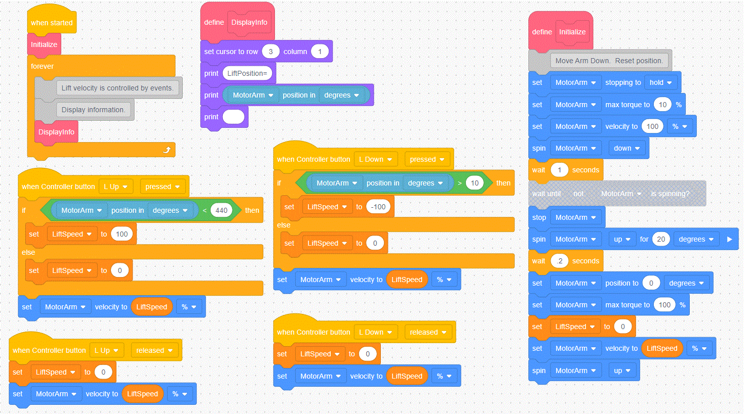

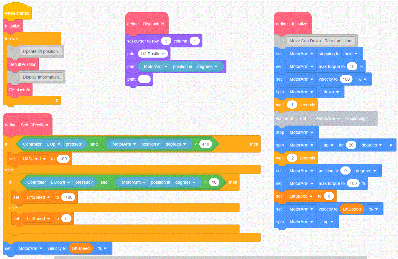

Attached are two code examples. One, RiseIfFalls, causes the arm to slowly fall. The other, RiseEventNoFall, does not have this behavior. Both programs do not stop the MotorArm motor at all, actually, so I guess setting the MotorArm stopping to hold doesn’t matter? The arm velocity controlling code sets the motor velocity and the motor is always spinning, as in the initialization. This is done to allow the programmer to change motor position/speed by changing the motor velocity. When whittling down my program to focus on the arm falling issue, I found that using an if-then statement to set motor velocity caused the arm to slowly fall, but using events prevented this problem. When either program is running, I press the LUp button to lift the arm to about 240 degrees, then release the LUp button. The arm slowly falls when running the RiseIfFalls program, and stays in position, more or less, when running the RiseEventNoFall program.

Ok, I see the issue, but it’s complicated to explain. The simple answer is that sending velocity 0 (or stop) in a loop causes the motor to reset some internal control parameters. Your event based solution only sends stop to the motor when a button is released, the loop based approach is constantly sending stop. The reason this happens is due to customers wanting to use the other motor brake modes, coast and brake. Anytime a zero velocity is sent, we have to tell the motor to go back into that mode. Anyway, I will see what we can do to improve this situation, there’s a VEXcode release planned for later this month, hopefully we can get some improvements for this use case into that.

Also, between the RiseIfFalls and RiseEventNoFall, the NoFall always sets the motor speed back to 0 (always as part of the else condition). Essentially putting the motor to brake hold.
However, in the SetLiftPosition function of the RiseIfFalls, on the outer if/then condition statement there is no set motor speed to 0. It just relies on the set motor arm velocity statement that runs immediately to set the velocity to the value of LiftSpeed, which is 0. However, I don’t know if that’s the same thing as Set LiftSpeed to 0. The NoFall explicitly sets the LiftSpeed to 0 after each else statement to lock the motor in hold mode.
Thanks for this explanation, jpearman. Looks like programming using events is what I will use for now. Or, I may set the velocity of the arm only if the LiftSpeed variable value changes, especially to 0.
Or… add in code to put your motor back Into the intended mode right after setting speed to 0.
