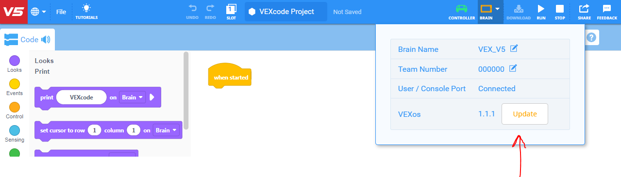

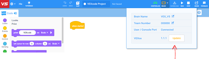

OP can try a forced firmware update, no harm in trying at this point.
An update could help. Since you’re new to VEX products, as you said, here’s how you perform an update.
  1. Open VEXcode V5 (NOT Pro, just normal V5 code.)
  2. Connect the brain to your computer and power it on.
  3. Click the brain icon.
  4. Click the update button

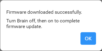

  5. Wait
  6. Once finished, restart the brain.
