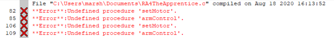

We got a new laptop for the next school year, and I got RobotC on it. I set up a program I knew worked, but This happened.
Does anyone know how to fix this?

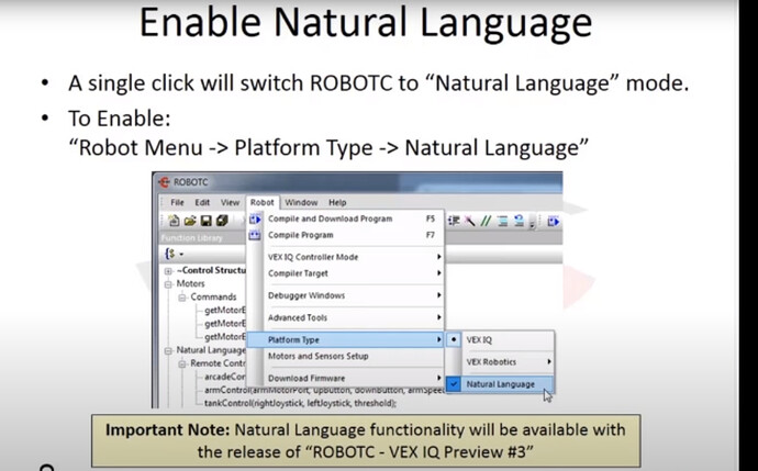

It looks like you need to select Natural Language 2.0 in ROBOTC. One of the top menus (file, edit etc) should let you enable it.
Thanks! I just compiled it and it worked.
