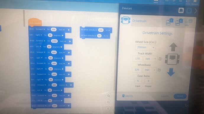

Hi guys, we are confused by the VEXcode Block. Since we updated the driving base gear ratio, from 1:1 to 5:3, the robot can never turn correctly with the program, even with the Gyro sensor. Before programming, We updated the gear ratio and other settings, but If we program a 90-degree turn, we may get a 75, or even more than 360 degrees. Just so confused. Please help.

Could be a few things, could you post a screenshot of your code?
Have you tried entering the ratio as 3:5? Or entering 1:1 and seeing what happens?
IMG_9905
Without Gyro
Sure, pictures updated, with and without Gyro.
If my program is on drivetrain, not the 2 motors separately, it seems I cannot calibrate the Gyro.

The specific issue with gear ratio is as I explained in the other topic, the gear ratio was being applied twice by mistake, once on the motor and again on the drivetrain, an error with code generation inside the blocks program. The practical effect of this was to this was to apply a gear ratio that was the square of what was entered. Although a bug, this should not have the effect of causing turns to rotate forever without ending and should have no impact when doing turns with the gyro. My point is that its unlikely to be the cause of all issues.

yes, it should be fixed in the next blocks release, I can’t give a specific date (that’s determined by the blocks team) but I would expect it to be sometime before the end of Feb.

There are two pretty serious bugs that would change the way an IQ program using the drivetrain will work. This one that affects the calculation of the number of wheel revolutions needed when gear ratio is used. The second bug was explained a couple of weeks back, the wheelbase setting is not being correctly turned into code, this affects drivetrain turns when gyro is not being used.
safest way to not have the update change any code behavior is use 1:1 gearing.
next would be to set gearing so that distances are correct and then make a one time change after the update to the actual gear ratio. for example, if gearing is physically 5:3, that’s supposed to be an internal ratio of 1.667, but we are using the square of that, entering a ratio that was square root should (and I didn’t test this with a robot) allow correct distances to be entered, in this case 4:3 would be close or 129:100 even closer. (1.29*1.29 = 1.664 which is approximately 5:3)
This should be fixed now with the 1.0.9 VEXcode release.
