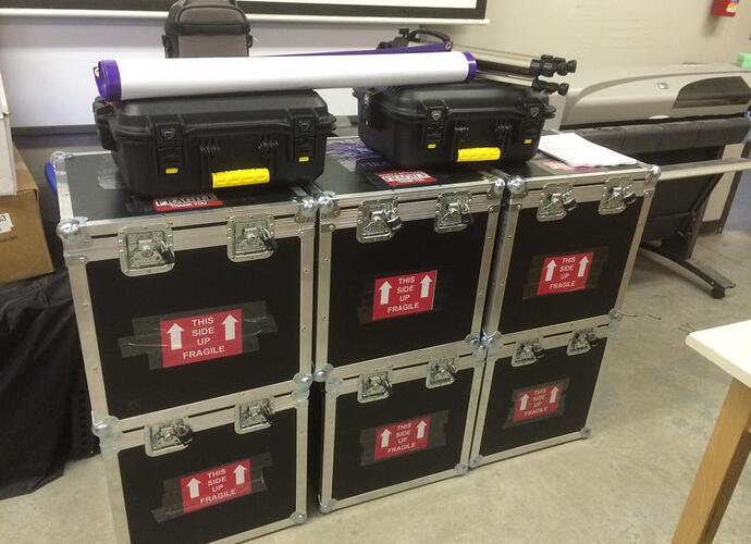

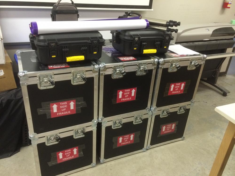

Here are the cases we use. They are a roadie case and we got them from a place online that is 99 dollar cases or something like that, just Google it. We paid around 350 or so for them and they are 19" inside and 20" outside. Worked perfect when we flew so should be ok for a long time. You can also see that we have cases for controllers and laptops helps make sure they get there ok. They are Plano pistol cases, work pretty slick!! Lockable and waterproof!!!
[ATTACH]9069[/ATTACH]
