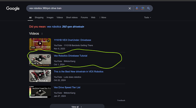

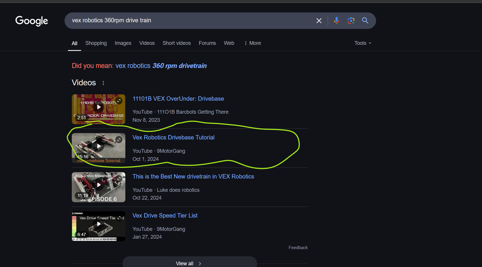

:skull: use the search bar. there are proly about 100 thousand threads here on VF on drives. and there are countless videos on youtube of cads and build videos for the exact drive you are describing.
Pleas please please take initiative next time and spend literally 5 seconds to type into the youtube search bar or google search bar for what you want . its not that hard.

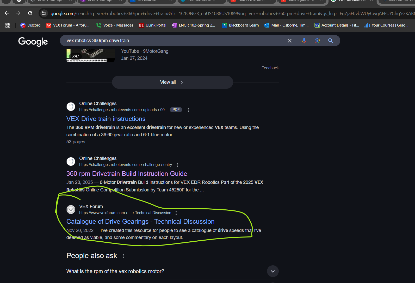

literally the second and 7th search results on google.
This will be your best friend: Catalogue of Drive Gearings
