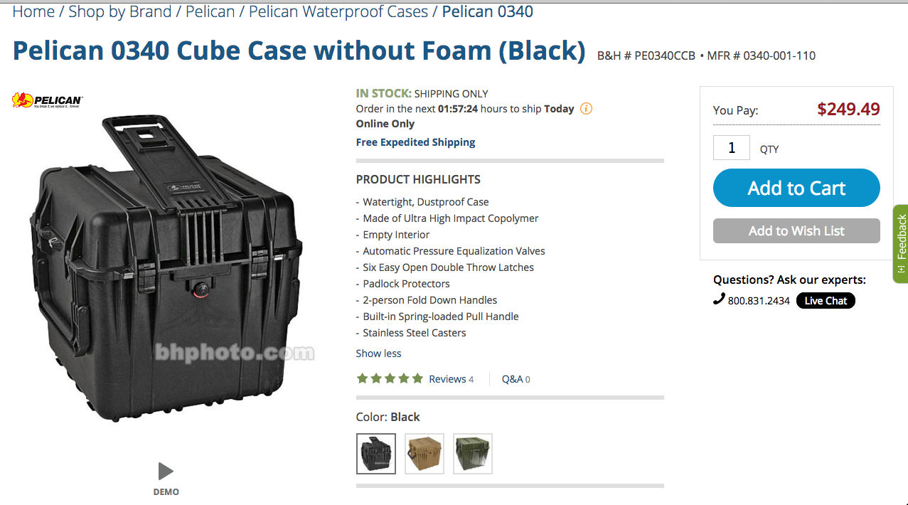

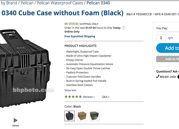

This Might Work For You
Its a Pelican Case. A little bit pricy but these cases are built like tanks.
