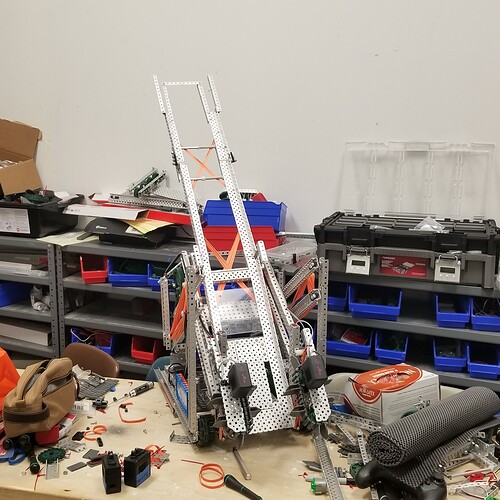

Truth to be told, I dont even know if there’s anything wrong, but you people might spot something I haven’t seen, so here it is.

Looking at your drivebase I would try to use omni wheels on your front. This eliminates wheel scrubbing which inhibits turning. It looks like your chassis is a little short. I would have fold in wheels on the back of your chassis which are tied to your tray. When your tray is lifted up pins would be pulled out. I can possibly mock something up later today.
Definitely do not cantilever the intake sprockets. It will bend your axles.
No worries, I understand what you are talking about. Will try and use that.
Also the all traction drive was a conscious decision on my part. I’ve already tested it and there are no problems with turning
It’s not a huge deal, but building as compact as possible is key to good builds. This not only gives leeway for complicated mechanisms, but also increases structural integrity because the stress on each system is distributed across a much smaller distance. So like the spacing on the chassis where your wheels are is unnecessarily large, the locking mechanism on the tray as well.
Don’t break your back trying to reduce spacing, whenever you do a rebuild however, you should be extra thoughtful to that idea. If you do this physically, you will encounter many frustrations, so I’d highly recommending CADing your robots first (or at least parts of it). You will find an extreme level of exactness that can’t be found elsewhere and allows you to build very compactly.
In general, if you look at many successful robots you will not see much empty space anywhere. Every last inch is occupied by something, and everything serves a purpose. This also ties to over-engineering. I hope this helps.
Lol this is exactly what I had on mind when I was rebuilding! The drivebase itself is a 14 inch square :smile:
But the tray, that’s an issue I’ve had trouble with. Any suggestions?
Well the locking mechanism is asymmetrical and it looks like you’re using a slider and c-channel. I think this can easily be accomplished with half cut c-channel and spacers and a screw joint. In fact, the 1727g initial robot reveal has a close up look at a locking mechanism concept that can be easily adapted to a robot. I recommend using that kind of design, it’s relatively easy to do.

I made a collapsable post to save space. There’s a ton of pictures.
General overview
20190914_175210
It’s 26 holes wide and 30 holes long. This is my bot right now. Please ignore the mess, it’s definitely temporary.

This is my deploy. My intake is held in by the tray and the tray is held by the intake rollers.

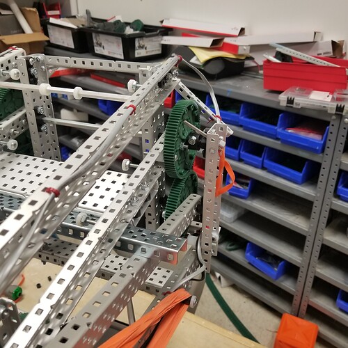

Lift closeup
20190912_183624
This is my lift gearbox. Ignore the axle on the rubber band, it needed to be held out of the way for something.
It’s a 2 motor 1:7 100rpm lift. There are 3 bands on the gears, around 15 on the bottom part, and about 15 on the top bar [per side]

Right now I’m planning to add extensions to the tray to push out the rollers so that I can drive back when I score because when I score in the corner I have to put a wheel into the scoring zone. In the past I would make the stack, untilt, and intake while simultaneously driving away. Another option is making the amount my tray will stick out longer, but that raises the tray further off the ground, making it more difficult for cubes to be intaked.
Please give me suggestions. I’ll post some videos of the issues I’m having tommorow or friday when I scrimmage.
Screw-Shafts: First off, your link between the tilter and the tray has more friction than it should. I see you have a good screw shaft on your arm which my team learned from this thread. Your tray linkage should have better screw-shafts. Using a screw as a shaft only works well if you tightly secure it to one linkage/bar and then loosely secure it to the other bar. That way there is no slop, but there is also limited friction. Here is how my students adapted the shaft-screw:
WIN_20190919_10_30_23_Pro
nut retainer, c channel, keps, teflon washer, other bar, bearing on the other bar, another teflon washer, thin nylock tightened and then loosened to the desired effect.
You can do this where the tray linkage attaches with the tray too.
Chassis: Your chassis seems to have no good trans chassis support. I would always recommend making sure a single c or L channel runs across the entire chassis and makes direct contact with every chassis rail. The reason for this is rigidity. Your chassis is going to flex a lot without it. You can just have the chain run underneath it and rub up against the structure lightly. If you are worried about friction, give it a layer of polycarb to slide along.

I actually have 2 chassis rails running all the way across, but they’re in the back so you cant see them
