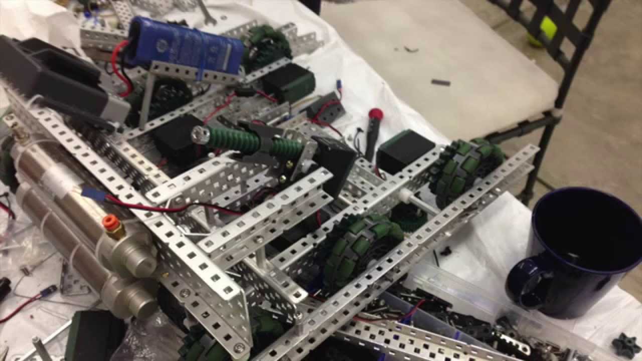

For the worm gear/screw, how many revolutions does it take to traverse that length? And does that translate nicely into IME counts or quad encoder counts which then gets you to a launch angle (which would depend upon placement of the worm gear)?
We went with the worm gear for a few reasons. We weren’t too concerned with speed since as long as you can get to the correct position in less time than it takes to intake a ball and line up, then it is fast enough. The most important thing about the worm gear though is that the recoil from the shot won’t be able to backdrive the tilt and affect the shot. Not sure how many rotations it takes since we didn’t play around too much with sensors but it takes around 3-4 seconds for the whole travel. The nice thing about the screw drive is that no PID is required and encoder values translate nicely into position and since it takes a lot more revolutions than a normal pinion and spur gear you can have a much wider range of error.
While talking about strategy, we decided that we should shoot our 4 preloads and attempt to get a stack of balls on the field and shoot them for the earlier competitions. We did not have enough time to complete autonomous programming during the three days. However, we will be improving this robot, including programming autons, over summer for sure.
If this were to happen, we would probably have multiple autons that would go where the opponent is not. On top of this, we might program some autons to play defense and interfere with the opponents auton. Once we update the robot and program a successful auton, I will post a video of it. :smiley:

This is a nice implementation of a roller cam-follower powered piston launcher,
and its great to see alternatives to the zillion wheel launcher calculations.
A possible enhancement would be to have the two motors drive the two cams + 2 springs independently, that some how allows spring strength to vary, instead of using pneumatics. Or control the shape of falling cam step such that motor speed at release can change launch characteristics.
Where did you get the shape of the cam?
Did you calculate the shape with the spring geometry and hook’s law to make the motor torque requirements constant per cam rotation?
If you didn’t do this, I’m guessing the cam radius grows too slowly at the start, and too rapidly at the end to be optimal; But its not obvious by the motor sounds in the video, so its probably not an important optimization to make, other than impressing some judge in the notebook competition.

What is the exact sizing of the nautilus gear compared to the one provided by VEX?
In your explanation video you showed closer photos of the launching system and from what I can tell the screws that hold the rubber bands on the piston part seem to be bending quite a bit. Do you think this will effect the consistency of the shots over time? And if so would this be an easy fix during competition?

We used an online nautilus gear calculator and photoshopped the gear teeth off. The “drop” on the nautilus gear is 4 1/4"
This was actually an early problem, however “boxing” the steel c-channels that the rubber bands were fixed to solved this problem. The slight upwards bend on these screws are caused by the screw going through the “boxed” c-channel.
