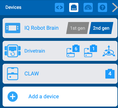

Hello. Thank you for your response. We are using Gen 2 devices. The Robot config is using Brain Inertial.
Hello1 Thank you for your response. I have included the code and the robot’s config, It seems to be correct… However, it hits the first turn right and spins in circles. I do appreciate your help!

Screenshot 2023-04-25 at 8.32.52 AM
They could’ve also forgotten to tell the gyro to calibrate
Thank you everyone for the feedback! You guys were right! It was a math issue due to the brain calibration. We recalibrated the offending brains and viola, they are working as they should!
Donna, probably worth drilling down a bit on your reply. Probably not a math issue but rather a failure to include a Calibrate block/ command in your start-up code? Pretty much routine for our guys. The usual routine is to make sure the robot is positioned as desired and then start the code which should contain a Calibrate command followed by a couple of seconds of waiting before proceeding.
Try calibrating the brain in devices
